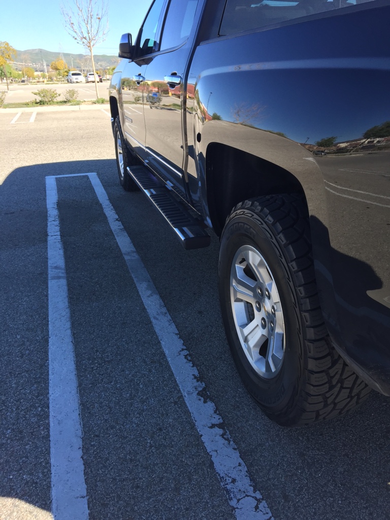

I have 295/70x70 with a +18 offset i havent trimmed anything and thats with the 2.5 rc kit , i could have gone a bit bigger i think youll be fine with a 295/70x18
