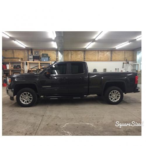

Had a 2" level installed today, still has some rake but i think that might have something to do with the max tow package i have.

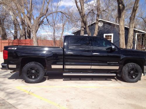

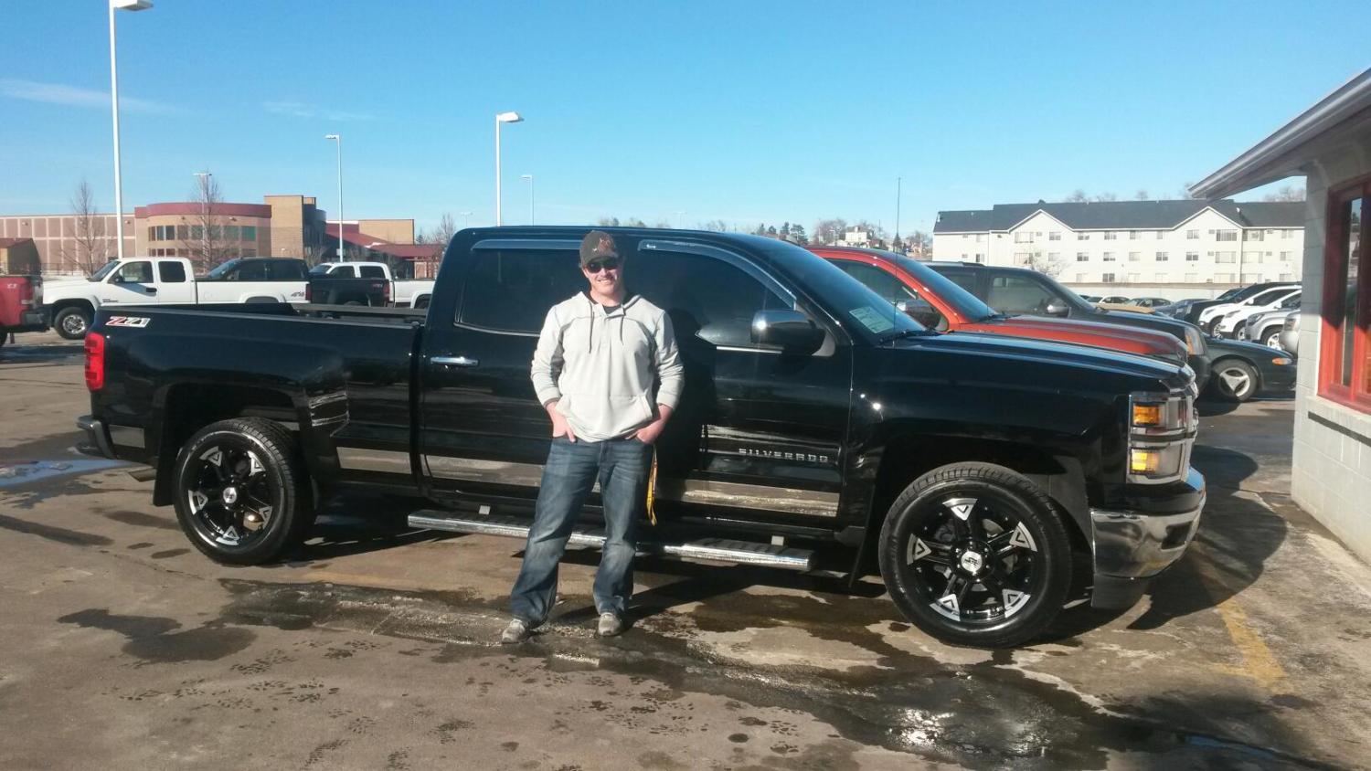

Finally got my new shoes in so, I figured I would put some pictures up. 2014 Silverado 1500 crew cab with the standard box. I installed the Bilstein 5100's at the highest setting on the front end and left the rear end stock. I also put on 17" XD Series Rockstar 2 wheels with 275/70/17 BFG All-Terrain T/A KO2's. As it sits now, it measures 38.25" from the ground to the top of the front fender and 39" in the rear. Before I installed the leveling kit it was 36.25" but there was a different wheel setup on it. Sorry the pictures aren't the greatest. I have removed chrome window visors and plan on debadging and removing the rest of the chrome as well.
Before:
After:
