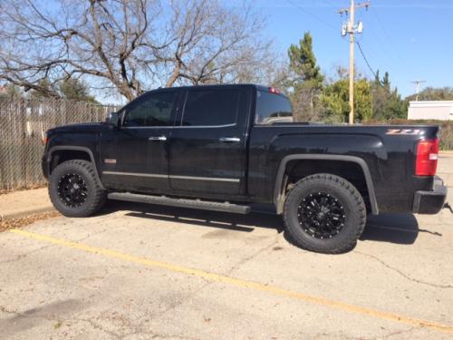

3" fabtech and I'm running 35.12.50.18 BFG All Terrain KO2s 0efb08f61a40b006f02eb2040ed0b805.jpg<br /><br /><br />Sent from my iPhone using Tapatalk<br/>

Tanner you're correct it sometimes depends on the tire and the how thick it is. The guy told me that if i went above anything more than +6 offset that my tires would rub the sway bar and i believe it. and yes at least 2" up front to clear 33's and the picture above hes running a 3" but i still dk how he doesnt rub unless the tread isnt very knobby. an 0 offset is the best way to go in my opinion

That's weird. Gmccoop is running 35x12.5 on factory 18's (with a 3" level) and allegedly isn't rubbing the uca or sway bar. A 295/70r18 isn't any bigger.
I know its hard to say for sure it's really trial by fire. There's a lot of people with 3" levels as well - running 35x12.5 on stock wheels with no rub ahah. Sometimes it doesn't make sense unless everyone is just saying what we want to hear.
There's a lot of factors, level, tires, offset, alignment etc. but I tend to just stick with the "gaurenteed" fitment specs for the population on here.
