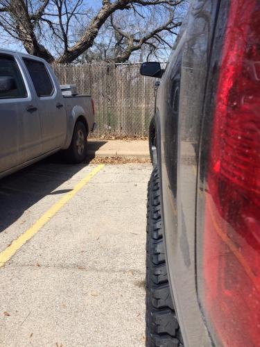

Got them on today, they look great will post pics later. a very slight rub on the wheel well on the backside middle of the front tire, very minor trimming will fix it, theres no rub on the front fender side. tires stick out almost an inch outside fenders
