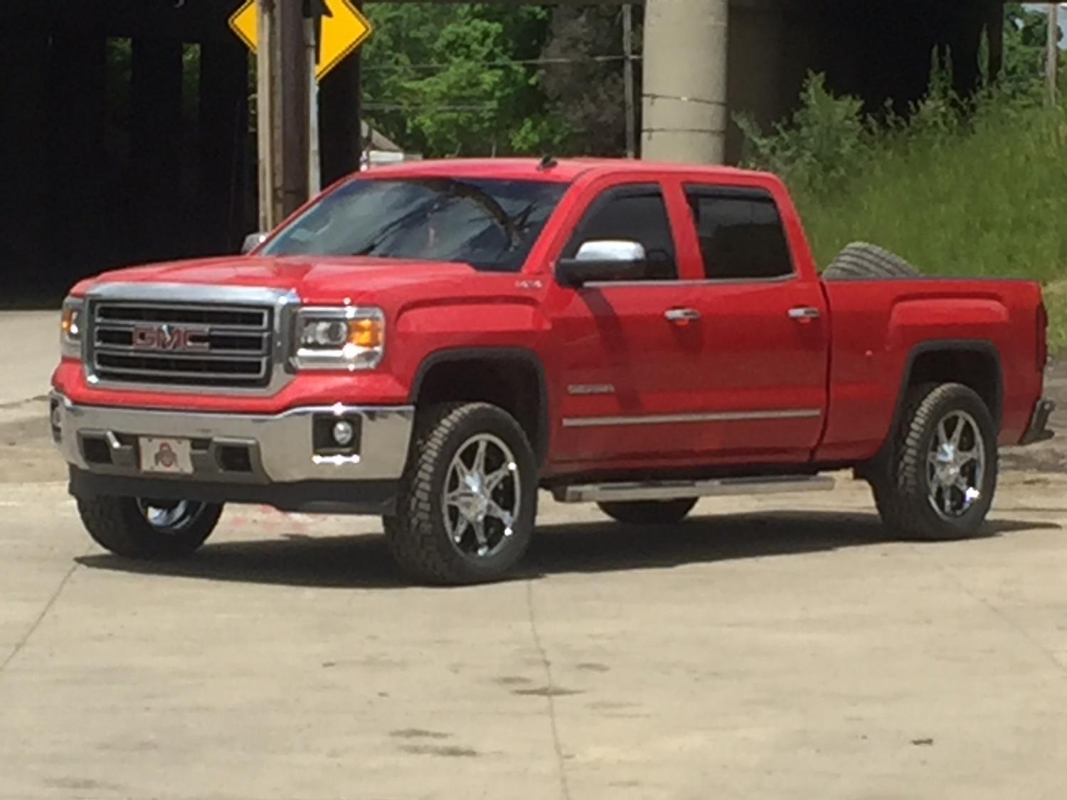

Last night I installed the Rough Country 2.5" lift on the front only and today put the MM 20x9 -12 with 305/50/20 Zeon LTZ on and could not be happier the the look or the ride
