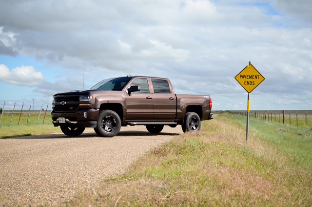

Will 275/70/17 fit on my 2016 with a 1.5 level and the stock 17 inch aluminum rims? Still might buy some 18 inch take offs but for now I will be running the 17's
These tires would probably fit without a level.
Thanks, truck looks good, I think I am going to stay with 275/70/17's for mileage and I also have a plow and do not want any rubbing issues when I am carrying the plow
Edited by MaineChevy
Yes. That will fit stock. These are 285/70-17 on a stock offset wheel with 1.5" lift.
This is an ideal combination of lift and tire size in my opinion! Nice truck!
07049408-4AC9-4E45-B716-1A09BF33A154_zps
With the stock offset how close to rubbing are you with the 1.5 level? I love the look of that size and wonder with timbrens upfront if I could run my plow with that size and not rub
Thanks
Haven't had them on long enough to notice as they're just temporary and a possible winter setup, but I have zero doubt it would be an issue, plenty of room.
Had those on my stock height '11 All Terrain with no rub. Actual specs are 17x8.5, +25.
