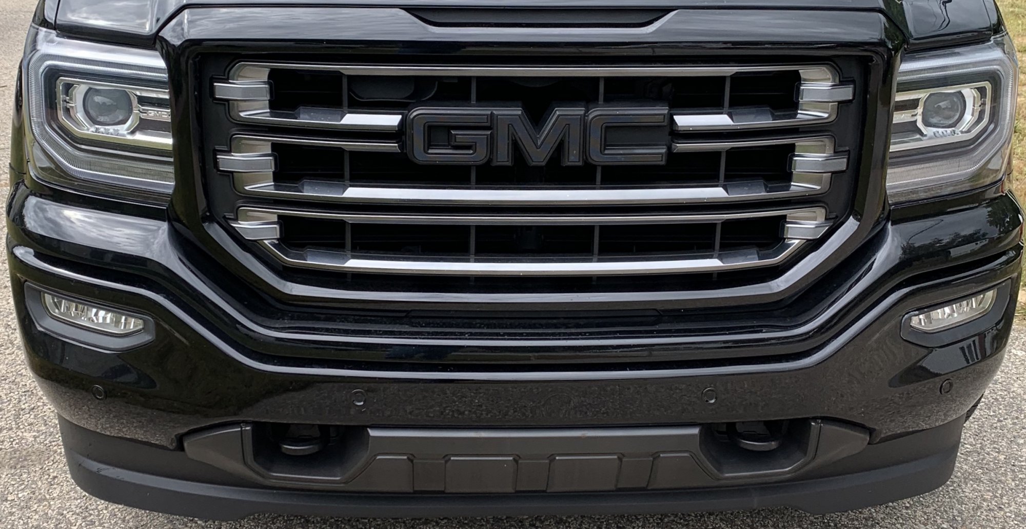

Pulled the grilled. Cleaned and lightly sanded the chrome inserts to create better adhesion. Used 320 grit finishing paper. 4 coats of Plasti dip, 4 coats of Rust-Oleum matte protectant for durability.
I have a 2015 ltz, just wanted to mute the chrome just a bit.f8ed13188364824338bb2ba6e23f45a2.jpg
