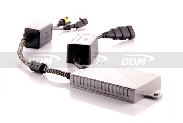

So you're saying don't worry about a canbus kit, get a capacitor link?
I did not get a canbus error eliminator or kit of any kind.
Right now I don't have any error indicators on the dash but every month when I get my Onstar email report, it says both headlights are out.
I need to hook up a resistor to the left and right headlight wires so the BCM thinks there is an bulb filament plugged in instead of a relay in order to get the report error to go away. Right now I am only using the passenger side headlight wire to drive the relay kit.
I'm not sure what the canbus kit or eliminator does and if it would fix this error message or not. I know resistors would fix the bulb detection problem but since I only get an error in the Onstar report, I don't really care.
