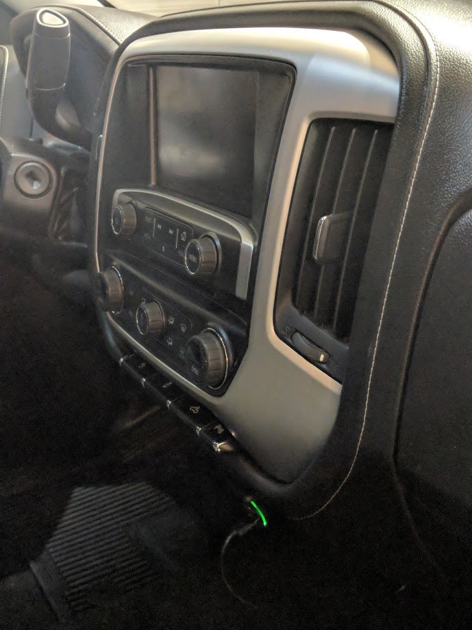

Edit: This color is low gloss axiom. They do not make a top console tray that matches this color. If you have this color and the grand lace wood door trim the part numbers you want are
Upper Trim Panel w/o outlet
Part Number: 84092097
Upper Trim Panel w/ outlet
Part Number: 23467123
Edited by zikronix
pic
You could always email your VIN number to Floyd over @ gmpartsdirect, and ask him to verify what color your trim is.
