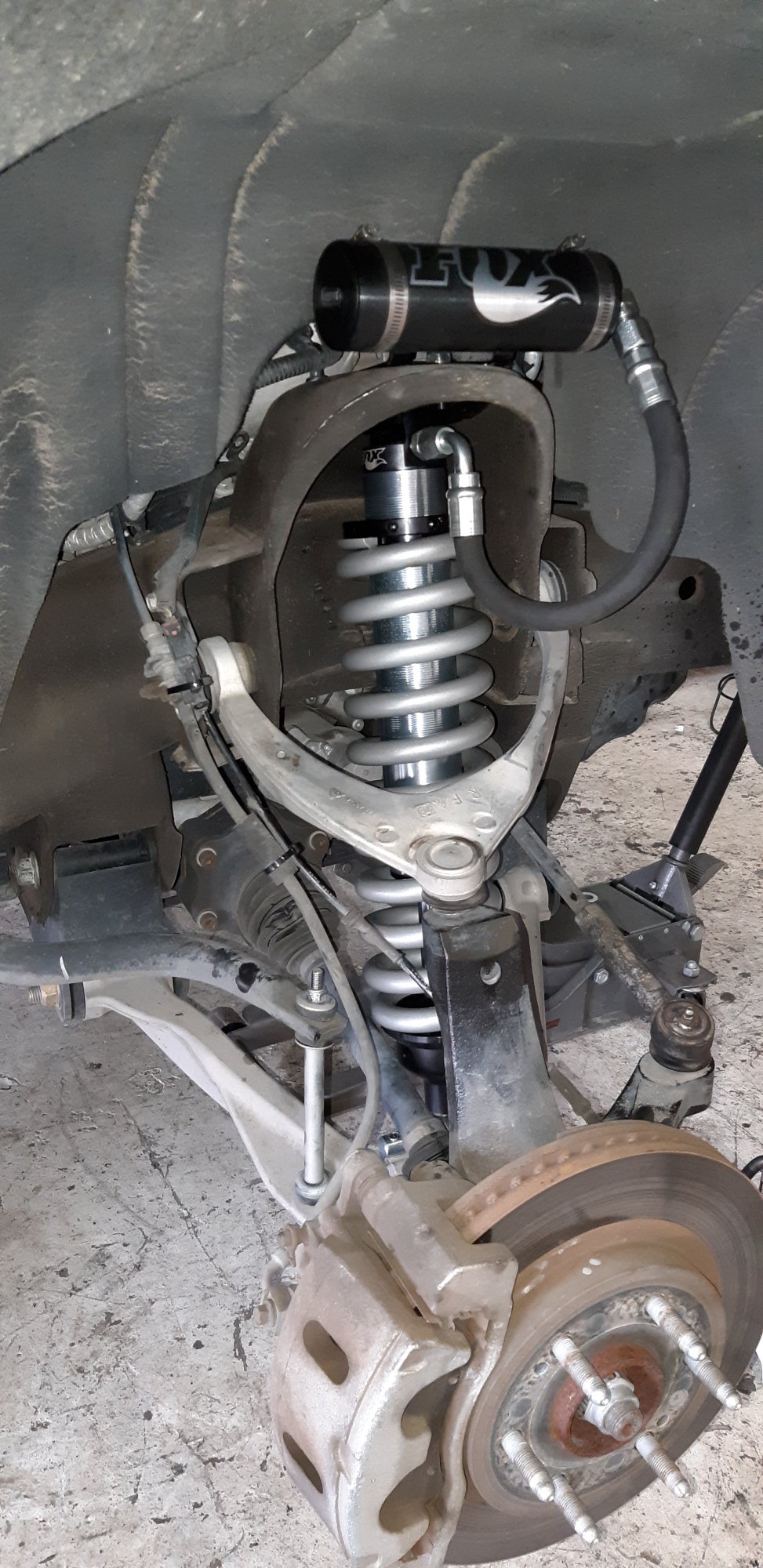

28 minutes ago, FlipZ71 said:
Removed front struts bilstein,  installed Fox 2.5 coilovers
Have you noticed a difference in ride with this setup? Softer or firmer than whatever is included with the zone (if you can recall)?
Yes , significant differance for me.
Hitting the large bumps , rough roads, the harsh bang I had is gone.
YES YES YES, That’s how you do it! Bravo
Stock aluminum UCAs?
Yes , stock UCA.    I will be upgrading those in a month. I wanted to make changes one step at a time. Tonight or tomorrow I'm removing the rear bilstein and installing the fox .
  • Thanks 1
Thank you, I will probably just do it all at the same time, then alignment and be done. Shout out to @TXGREEK for his help in me starting to understand this all.
Edited by SS502
Excellent job, better doing it step by step. So many people will just order everything at one time, better off step by step cause you know what you’re looking for after coil overs are installed.
