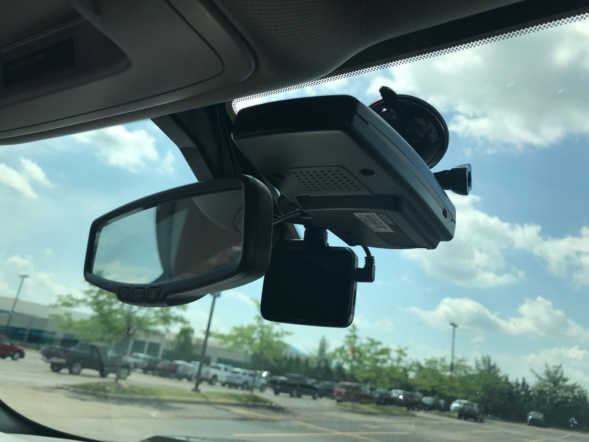

On 6/18/2019 at 8:57 PM, cpaul55 said:
Do you have any pics of your setup?
I'm a bit late responding to your request, but here you go.
