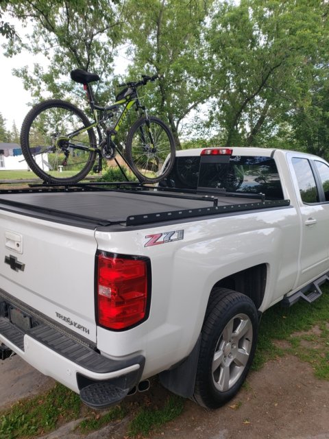

.. threw together a bike rack option to my cargo rack using strut channel and a couple second hand bike roof racks. First of two installed.. still need to fine tune the layout of the rack and set it a little farther back from the cab.. tomorrow

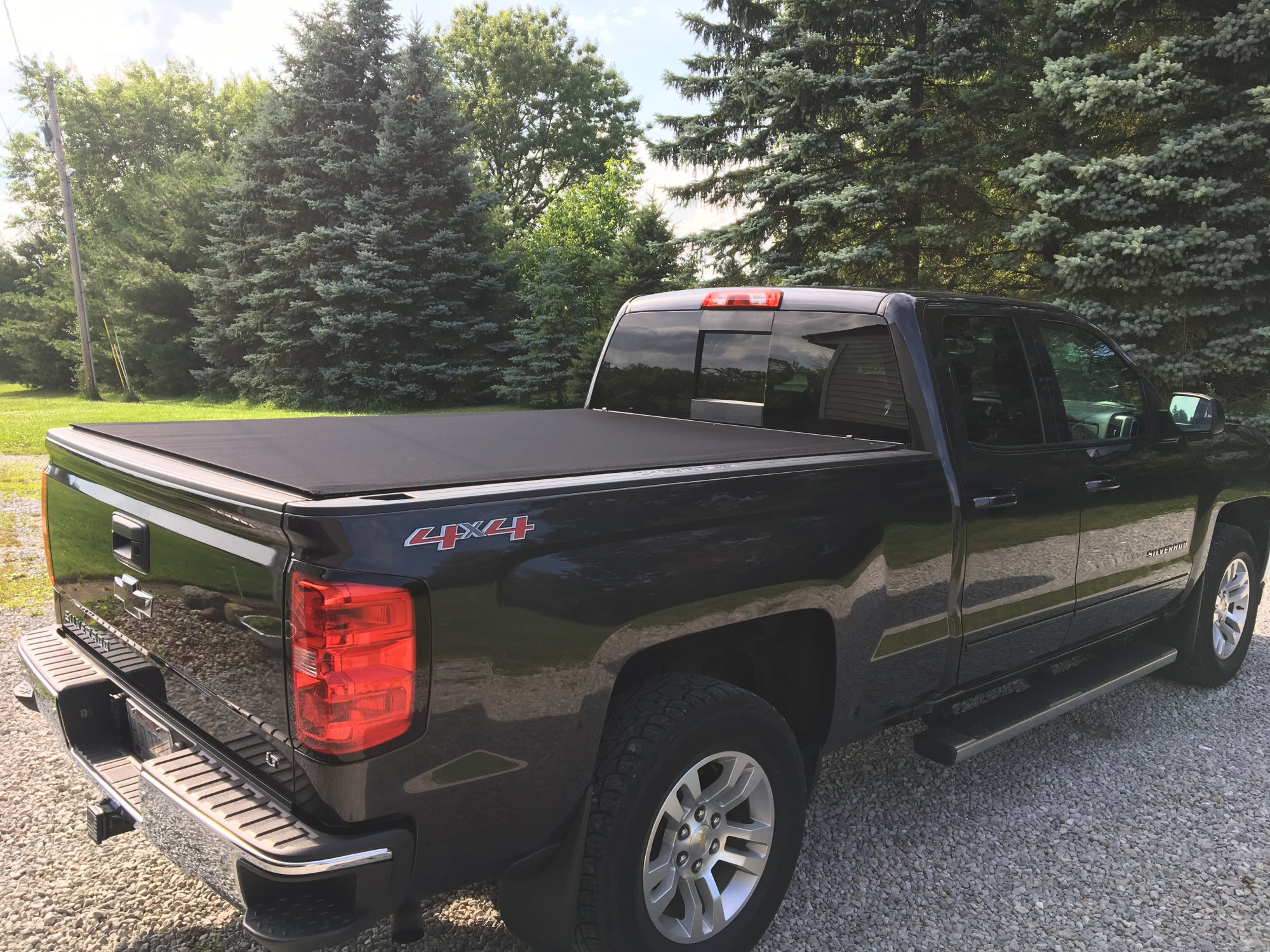

Replaced the Tonnopro Hardfold with a Truxedo Pro X15, it's a soft roll up with canvas over vinyl... I was tempted by the Sentry which is the same roll up with the canvas top but, has hard aluminum slats too but, it was $890 w/ 3yr warrant, this was $490 & has a lifetime warranty....
