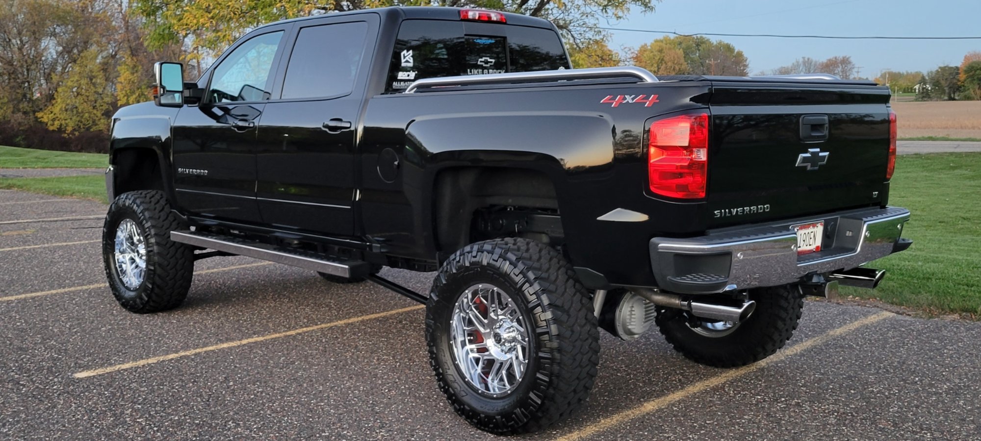

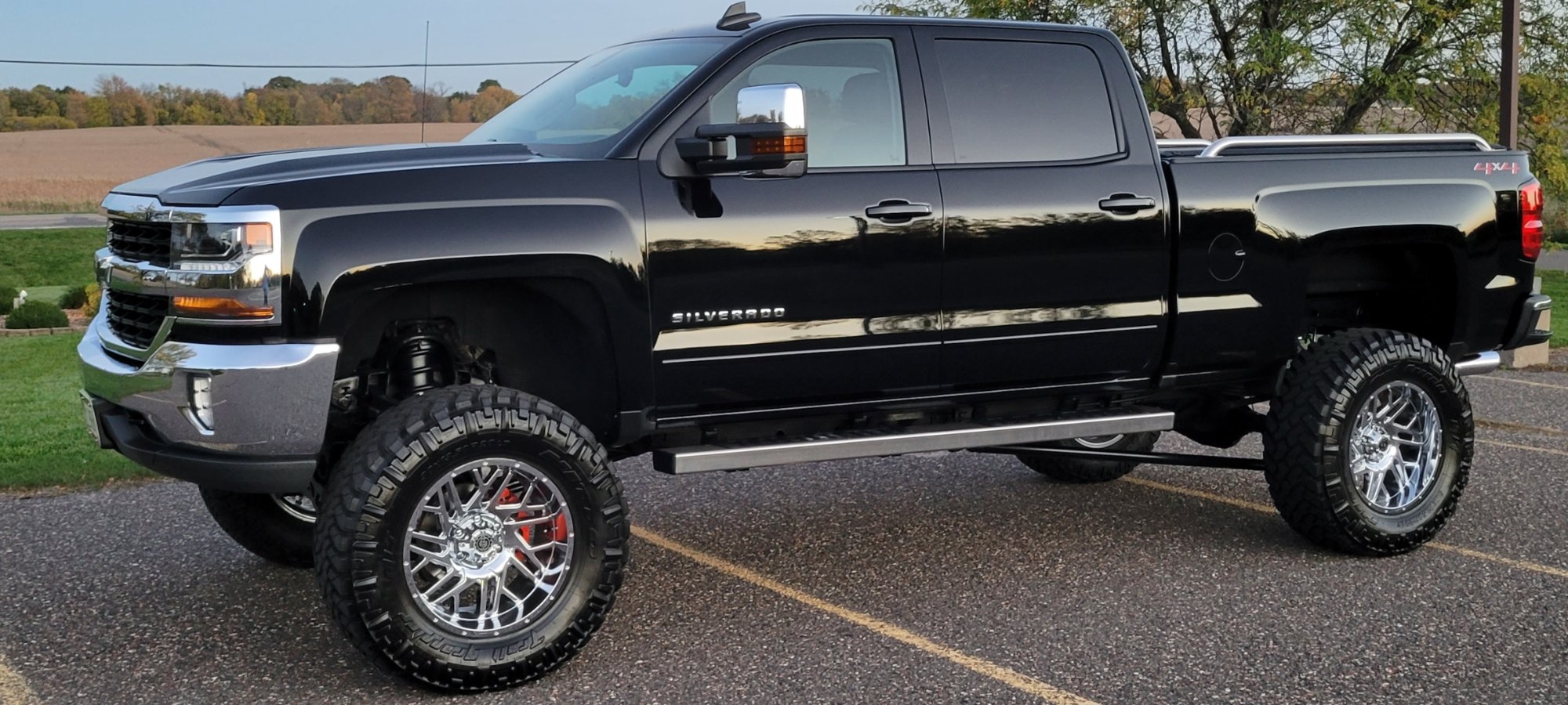

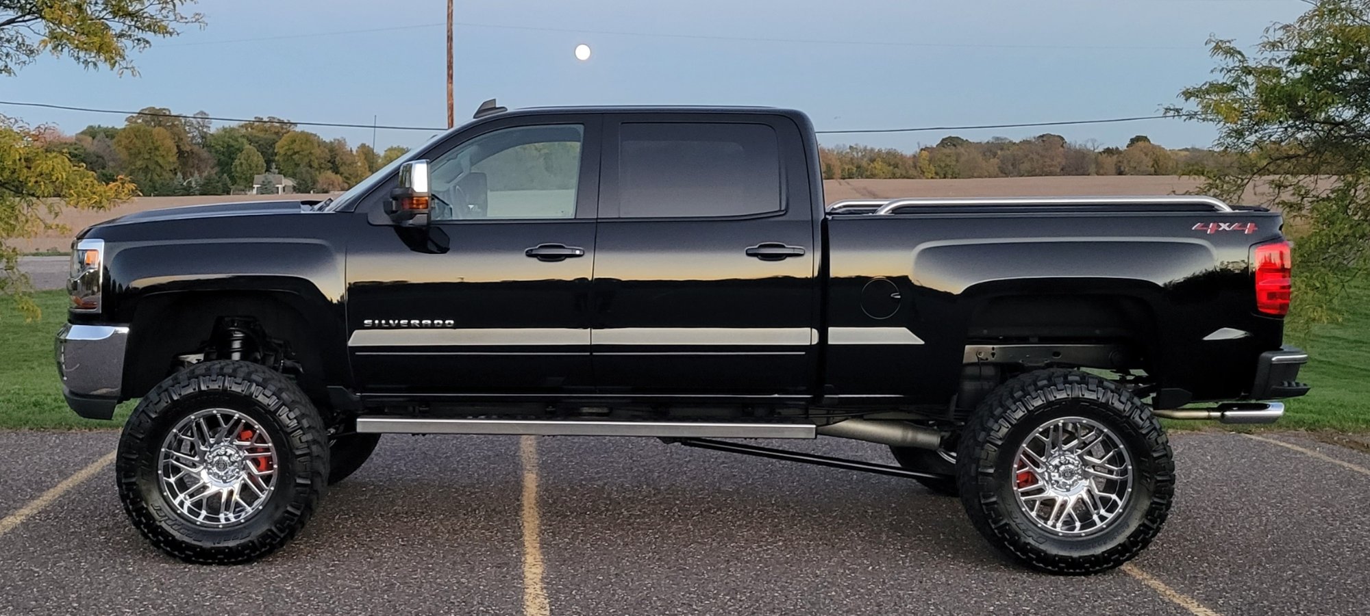

Took some pics .......
Your going to wash the paint right off that thing!
:rolleyes:

Nah
It has about 14 layers of Colinite 845 and countless layers of Need for Bead and Dream Maker.
She sure shiny

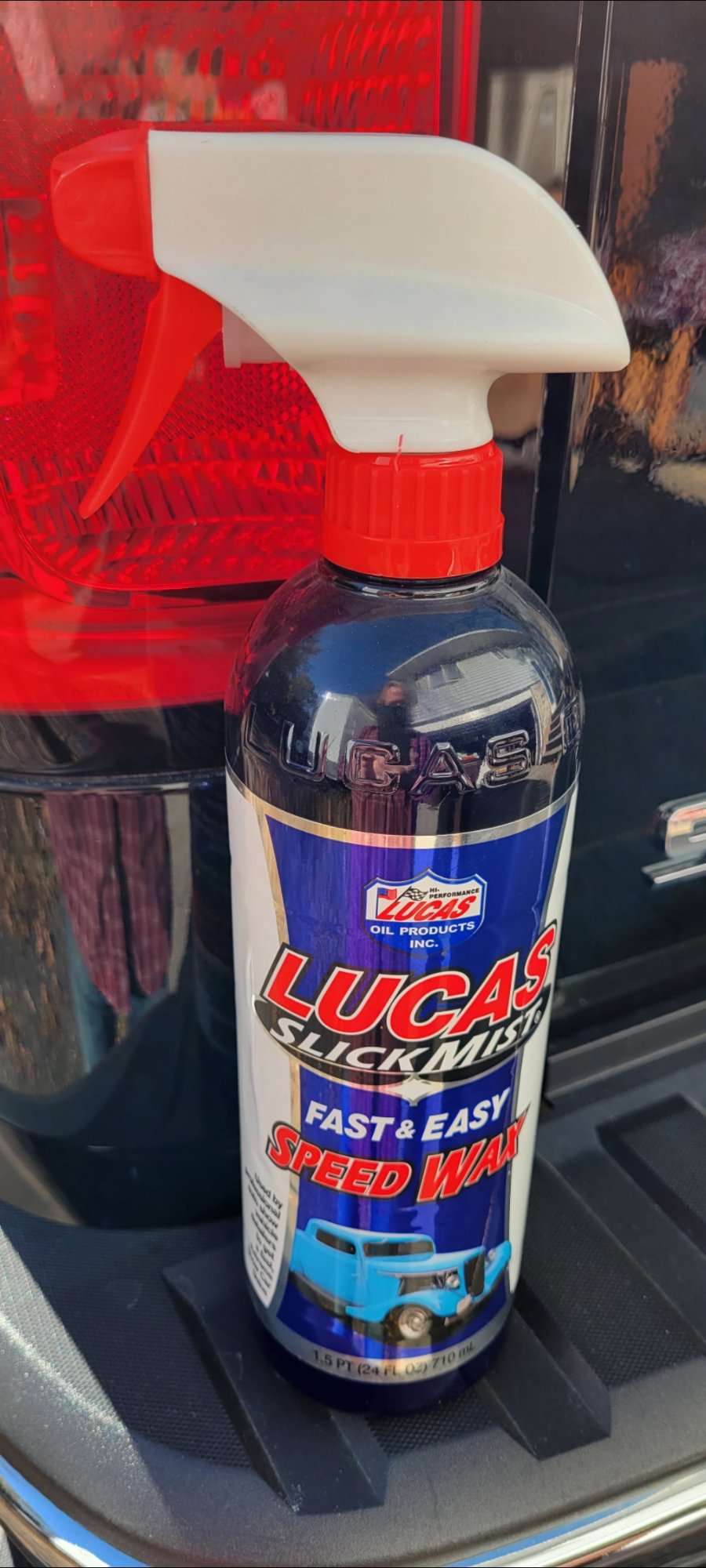

I love Collinite 845. That is great stuff.
I'm going to squirt some of this on it today just for the hell of it.
Got a bunch of this I need to use up.
Nice days are numbered here in MN
Damn, Jim! Looking good! :)
I do believe this could very well be the cleanest black truck I have ever seen, sir.
I bet that thing turns some heads! only a matter of time until snow flies.. been putting off my detail/ceramic coating for a few months now, just hoping to get it cleaned up and throw a glaze then wax over it before it's too late
