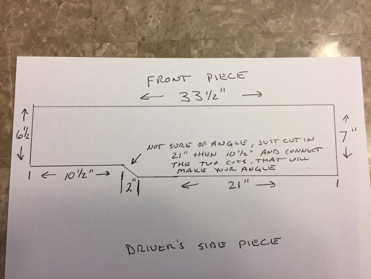

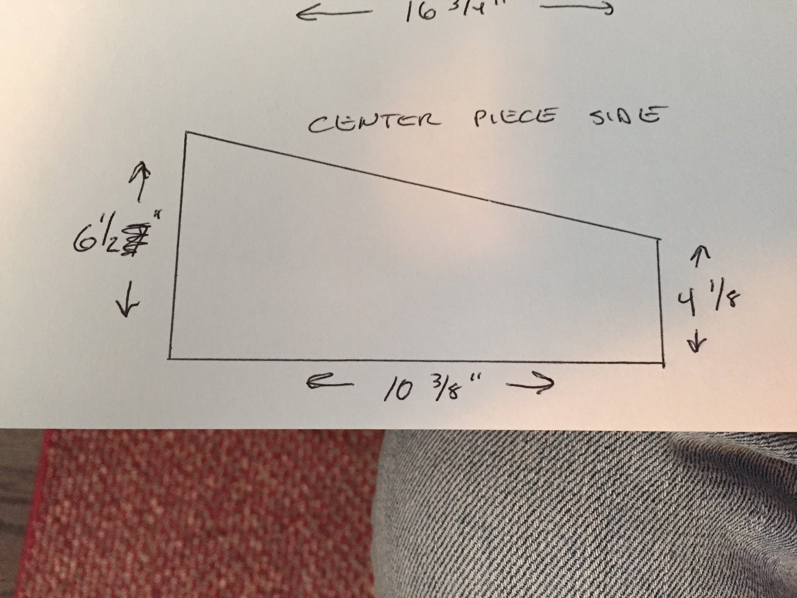

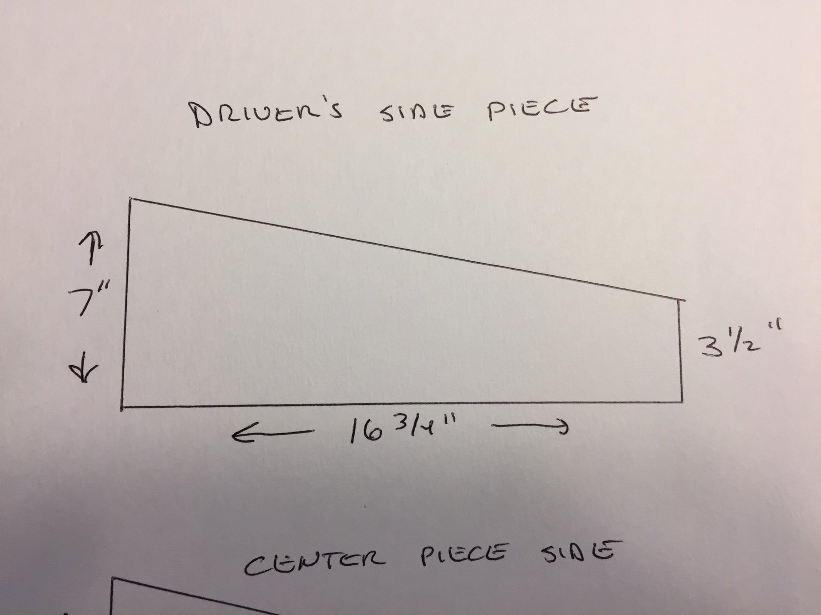

After hours of searching for an under seat storage system that would work with my factory sub, I finally decided to make my own storage box. With some 5/8" scrap plywood, "L" brackets, automotive carpet, and a couple hours of measuring with cardboard mock ups, here are the final results.
Here are the plans for those of you that were interested in them. Drawing is not to scale, but measurements are correct. Side pieces go behind the front piece, so the front piece of 33 1/2" is your total width. Drivers side secures to the seat mounting bolt. there is enough room to thread a lock nut on there. Center side secures to the sub mounting bracket. I will post pics of securement next.

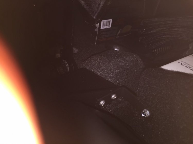

I used a flat "eye" bolt type securement for the drivers side and a "L" bracket to secure to the sub mounting bracket.

Sorry Guys, had to correct a measurement on the center side piece.
