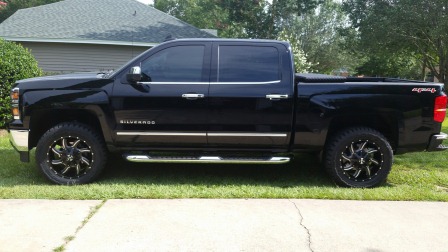

20x12 Hostile Havoc Blade Cut Wheels
305/50r20 Toyo Open Country AT2
2.5" Level
Truck looks bad ass [emoji106]
2.5" Level
Truck looks good man. How much trimming did you have to do to fit those x12's?
Thanks boss!
Quite a bit man, I had to cut the liner and cut some metal. I need to get back under there because the passenger side still rubs a bit. It's a very tight fit.

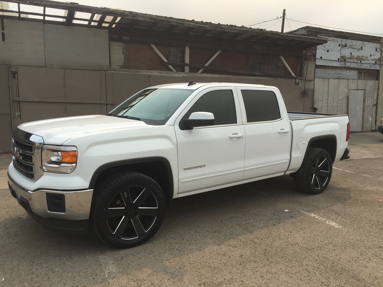

Wheels: 22x9.5 Foose Switch-F158 (Offset/30)
Tires: 305/45/R22
As of now, the suspension is completely stock. No rubbing on the front or back.

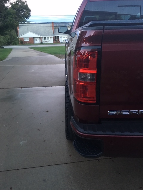

I read every page of this forum and didn't see this exact set up.
Rough country 2.5 level with rear block
KMC Badlands 20x9 -12 offset
BF Goodrich K02's-was nervous about this tire as I haven't spoke to anyone that has them. I have had Wrangler Duratrac's on our last 5 vehicles and currently on my rubicon. I will say after driving for just 2 weeks with them that they are a great all around tire and would highly recommend.
Looks good! What size tire are you running?
They are just 275/55/20s. I was nervous about rubbing because this is the wife's daily driver/babymobile. There is a ton of space to fit 33's with that offset. That's what I'll run next. It also helped that I got these for $215/tire.
Careful with 275/60. I rubbed at full lock in reverse at -12 offset. No rubbing other than that though.

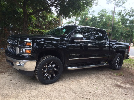

20x9 +18 Cali Offroad Twisted with 33x12.50x20 Toyo RT
2.25 Ready Lift leveling kit. Nothing in rear. Thinking about adding a 1.5 Zone body lift and swapping out the wheels for a set of 20x10 -24 offset. What do you think?
