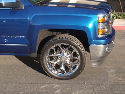

Good looking truck and nice wheels. The 305/45/22 is 32.8 in diameter and the 285/45/22 is 32.2. That's about 9/16" total O.D. and only about 1/4" on sidewall height. I don't see how 1/4" would be too short for your liking or even noticeable by just looking at the tire. The 305 is a bit wider with a 12" tread width compared to 9.5" tread width on the 285. I think the 305 is a little too wide for factory 9" wheels on a stock suspension and is why they rub. The 305 is designed for a 10" rim and will give the "balloon" look on a 9" rim. I'd stick with the 285. I have similar wheels (CK159) instead of your CK158. I'm running Cooper Discoverer SRX 285/45/22. They fit the 9" wheels perfect, were road force balanced and ride great.
I agree that the difference in sidewall and OD is minimal, but I wanted a little something extra all around. I have 285/45/22s on my lowered Tahoe and love the way they look. However, these trucks have a completely different look than Tahoes, so I don't mind the extra bulge around the rim (I know exactly what you're talking about. I saw that size on a Tahoe and thought they looked like balloons).
Very nice ride, by the way. I was debating between the CK158s and CK159s. You can't go wrong with either.
Thanks for the compliment bud. I was debating on the 158s and 159s myself. Ditto that, can't go wrong with either.
