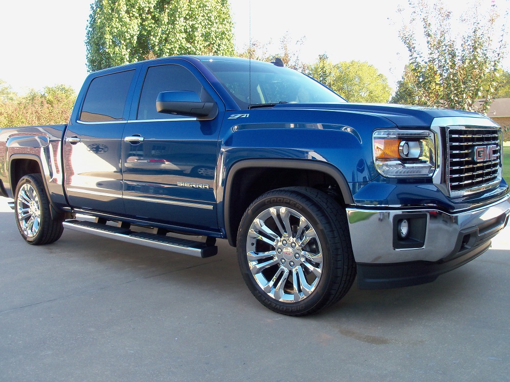

This setup looks so good. Can you post some more pics? Like some shots down the side and from the front and rear? I've got a set of 20s with 305/55s in my garage but these trucks look so Good with 22s that I'm rethinking my choices.
Here you go (FYI - I have no idea how to make the pictures show up as large images)

Thats good to hear. I wonder if 305 45 22s would still rub with my 2" level... when you are at full lock, and rubbing can u see if this looks like it would still be an issue if it was leveled?
I believe I've read that others are running 305/45/22s with a 2" level and had no rubbing. I looked last night and I don't see any signs of rubbing anywhere. There's no marks on the wheel liner or sway bar.

I posted this pic a couple of pages ago. Running 305/45/22 Terra Grapplers with no change to the suspension. Only slight rubbing in reverse at full-lock. Rides a bit stiffer than stock, but it's not terrible. The sidewall on the 285/45/22s was just a bit too short for my liking.

The 285/50/22 would fit easy, especially with a level. But unless you need a E rated tire, I'd probably just go with the 305/45/22. The 305 is less than .5" shorter and a little wider. Probably not noticeable to the naked eye, but is only LT rated so it would be lighter and ride better. If I go with 22s, thats the decision I'd make. The 305 is also quite a bit cheaper than the 285/50/22. Not sure if the extra .5" is worth the price premium.
The 285/55/22 would maybe fit on stock wheels with a 2.5" level, maybe need a little trimming or a small BL. It's about the same size as a 275/65/20 and lots of people fit those with just a level.
The 325/50/22 would be rubbing all over the place on stock wheels because of the width. Height might clear with a level and BL.
Good looking truck and nice wheels. The 305/45/22 is 32.8 in diameter and the 285/45/22 is 32.2. That's about 9/16" total O.D. and only about 1/4" on sidewall height. I don't see how 1/4" would be too short for your liking or even noticeable by just looking at the tire. The 305 is a bit wider with a 12" tread width compared to 9.5" tread width on the 285. I think the 305 is a little too wide for factory 9" wheels on a stock suspension and is why they rub. The 305 is designed for a 10" rim and will give the "balloon" look on a 9" rim. I'd stick with the 285. I have similar wheels (CK159) instead of your CK158. I'm running Cooper Discoverer SRX 285/45/22. They fit the 9" wheels perfect, were road force balanced and ride great.
