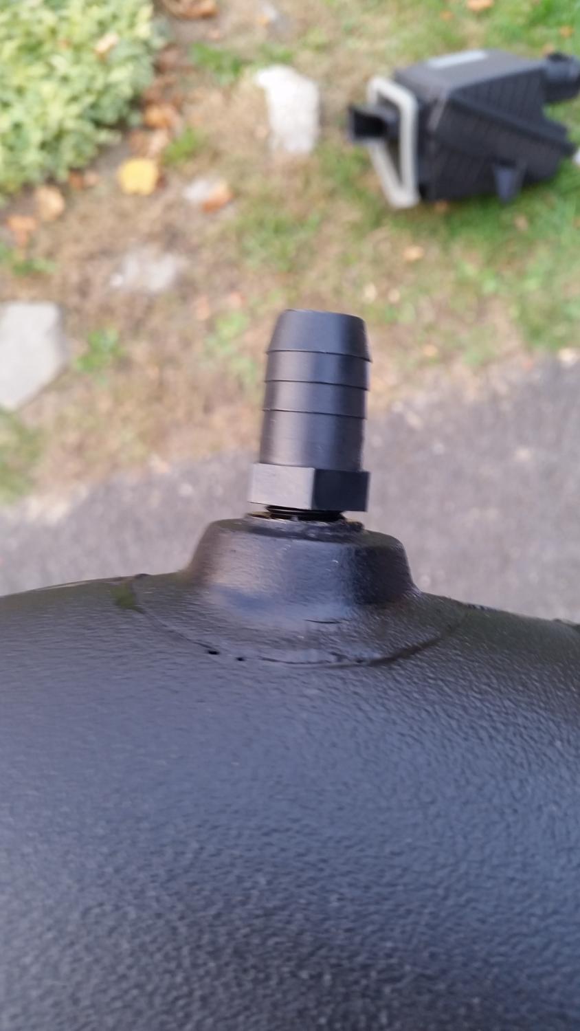

i was tempted to just ignore the instructions on this one and tighten the plastic pieces in all the way but i did it by the books. i just tightened them hand tight then screwed them in with a wrench two full rotations.

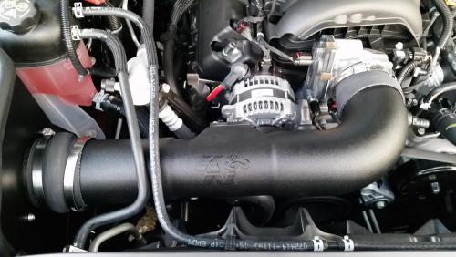

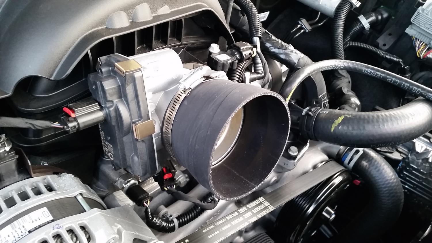

after both the plastic hose fittings were installed you need to fit the duct in the boots from the filter and on in to the throttle body and once everything is lined up right tighten all the clamps. make sure the clamps are putting pressure all the way around and not falling off on any part

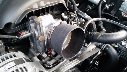

heres end by the throttle body and the clamps.

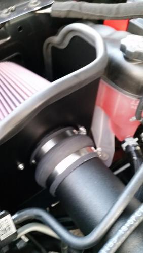

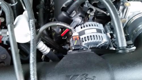

and the end by the filter

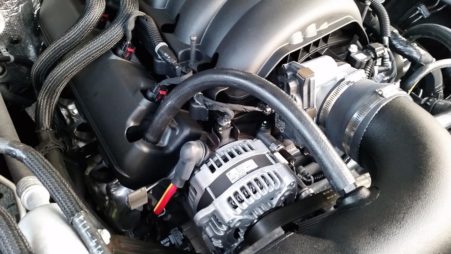

when i installed the breather hoses i made sure they went over that little lump on the engine side. doesnt say anything about in in the instructions but i thought that might make it a little more secure. i dont know if im just being paranoid or what. i even considered getting some zip ties but that might be overkill

just go back and make sure eveything is tight and secure. i ran the engine for a few minutes after the install with the hood open just to check. everything went smoothly so i got to put the cherry on top
