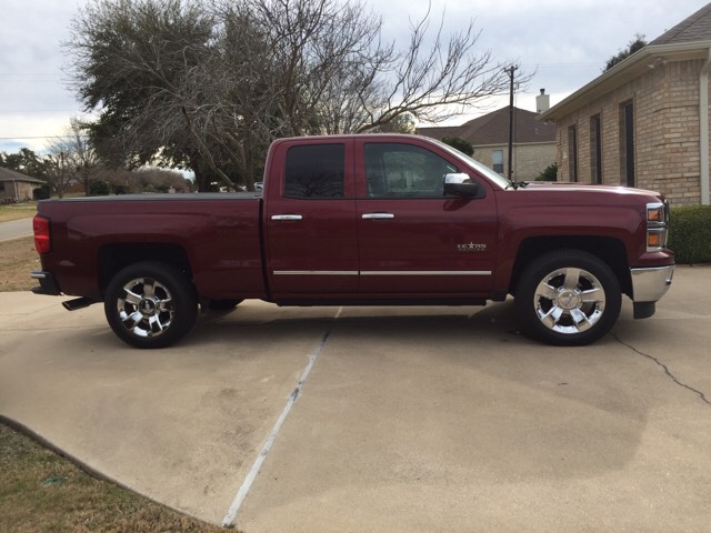

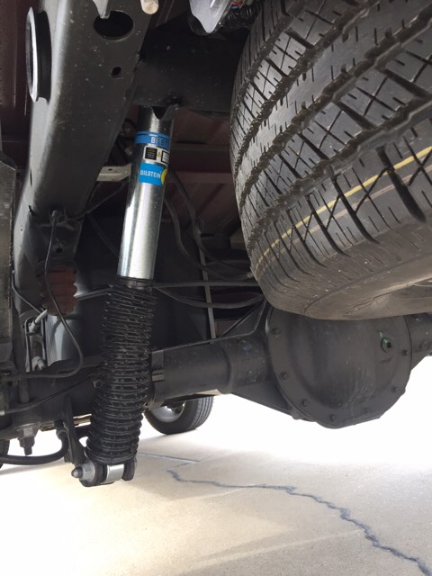

Had the front installed at stock height and installed the back myself. Ride is very much more controlled and smoother than stock. Going over railroad tracks and speed bumps much better. Since I did not change height, there is only a minor difference in front height. Not sure if pics are meaningful, but here thy are...
Sent from my iPad using Tapatalk HD

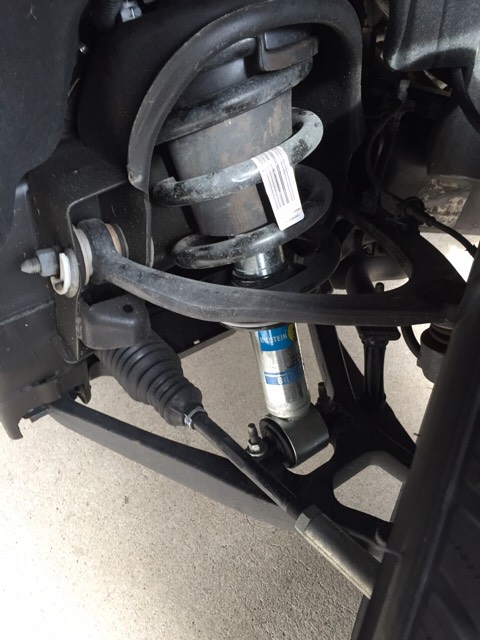

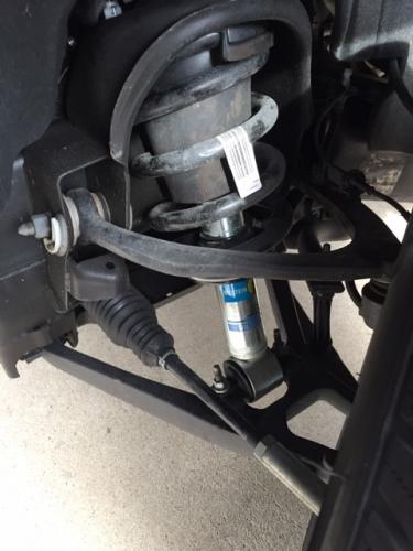

I got mine installed today. Front raised to maximum height. Only drove it 30 miles but I love them, much better than stock shocks with the 305/50/20" all terrains I'm running. Here's the before and after pics.
So your able to clear 305/50/20s with the bilsteins at 1.8? Also what was the fender height before and after? Did it only lift it 1.8" or a little more?
Hows the ride on stock height over speed bumps and such?
I was able to clear the tires Without the level. I drove it about 2,000 miles before the level. The 50 series tire is the same diameter as stock so its only wider. I think it lifted it the 1.8 but I haven't measured it yet. I wanted a small rake so this was perfect for me.
I actually bought 1.5 inch spaces first but after reading the performance of the Bilsteins and really not liking the handling of the truck with the 305s over speed bumps, bumps on the highway, potholes and road ridges, I decided to order the shocks. They are definitely much better than stock with the 305 all terrain tires.
