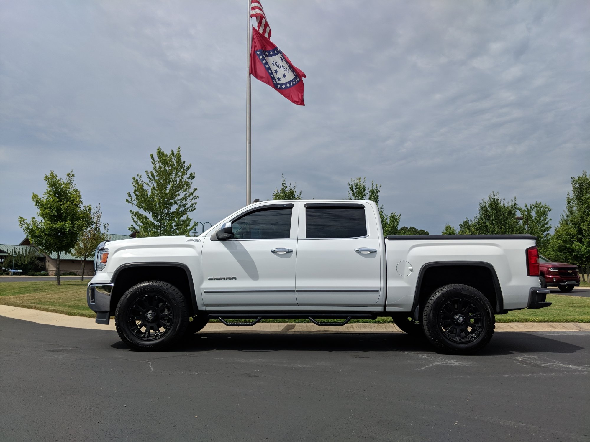

I had the Rough Country 2 and 1/2 in level lift on my 2015 GMC Sierra. This also included the 1-inch over block in the rear. I removed the front Rough Country components and replace them where the Bilstein 5100 on the highest setting. I left the block in the rear, and installed the 5100 and place of the Rancho Shocks. With a Z71 suspension a truck never really was what I considered a smooth ride, so the 5100 really didn't make it any smoother. What they did do was tame the ride. The sloppiness and bounce was replaced with a firm solid hit that settled out quickly. The truck felt more planted, with the ability to settle out much quicker. Here's a picture of how the truck looked with the 5100 on the highest setting, and the one inch over block. Tires were 275 60 R20.
