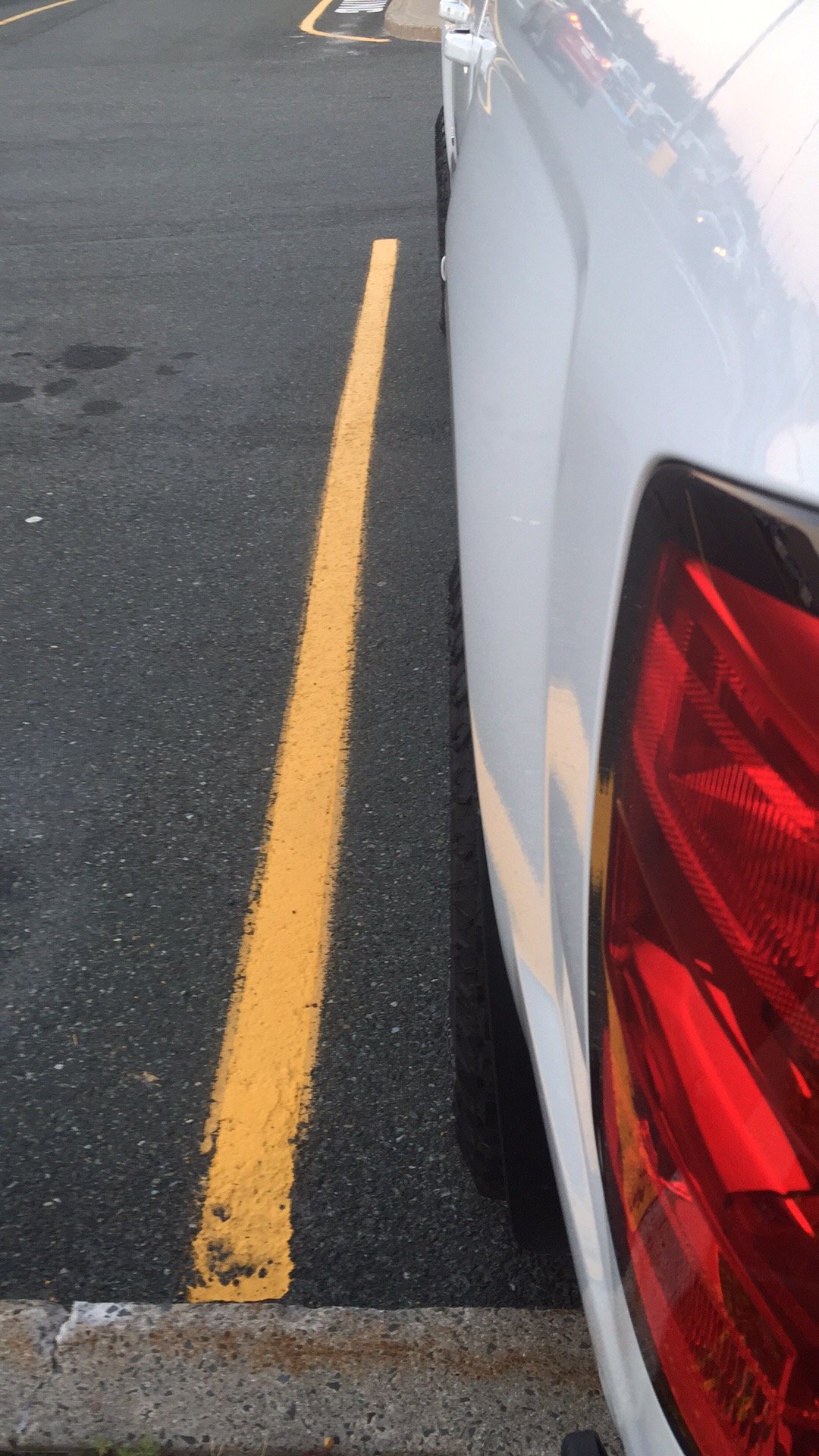

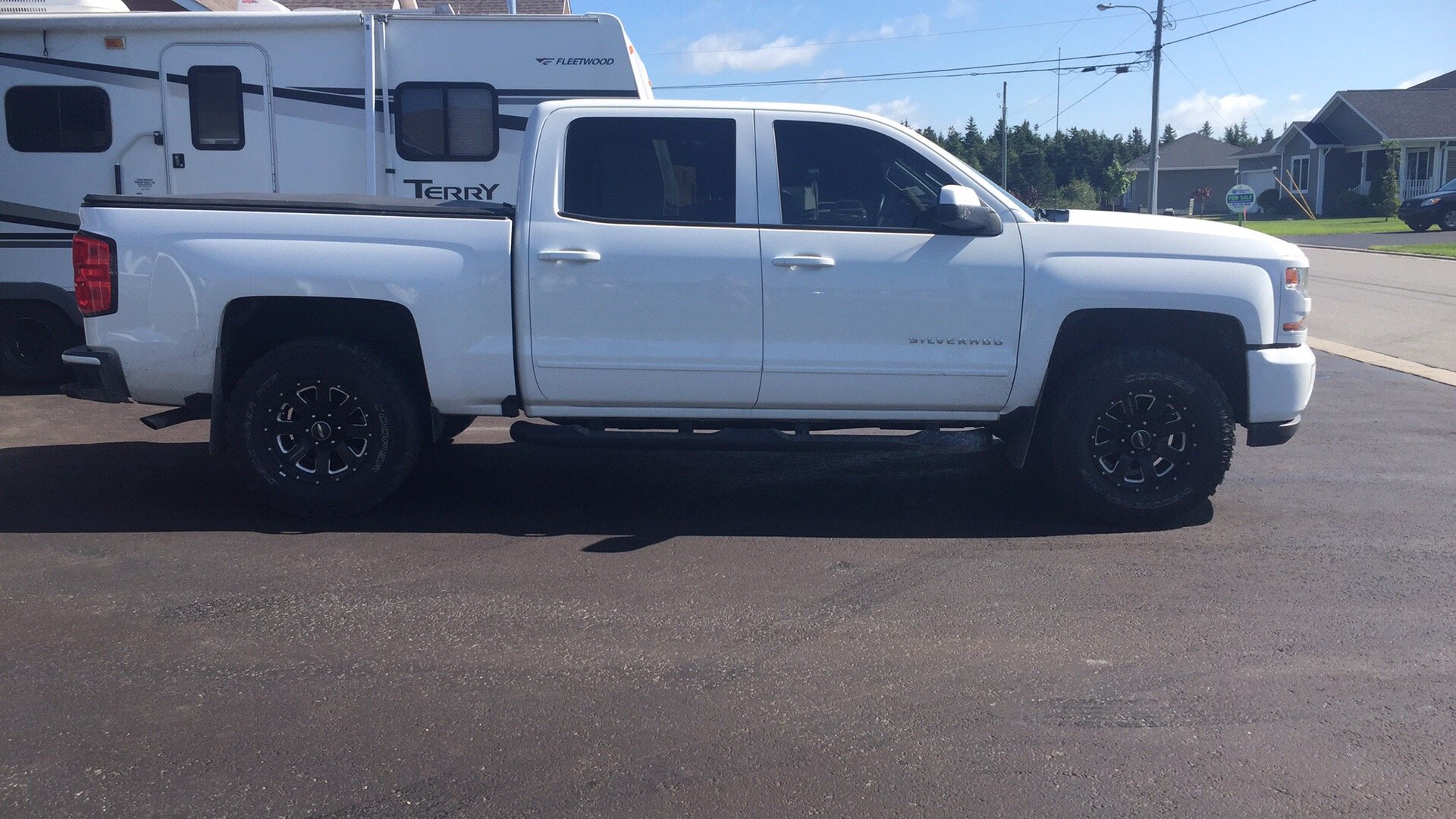

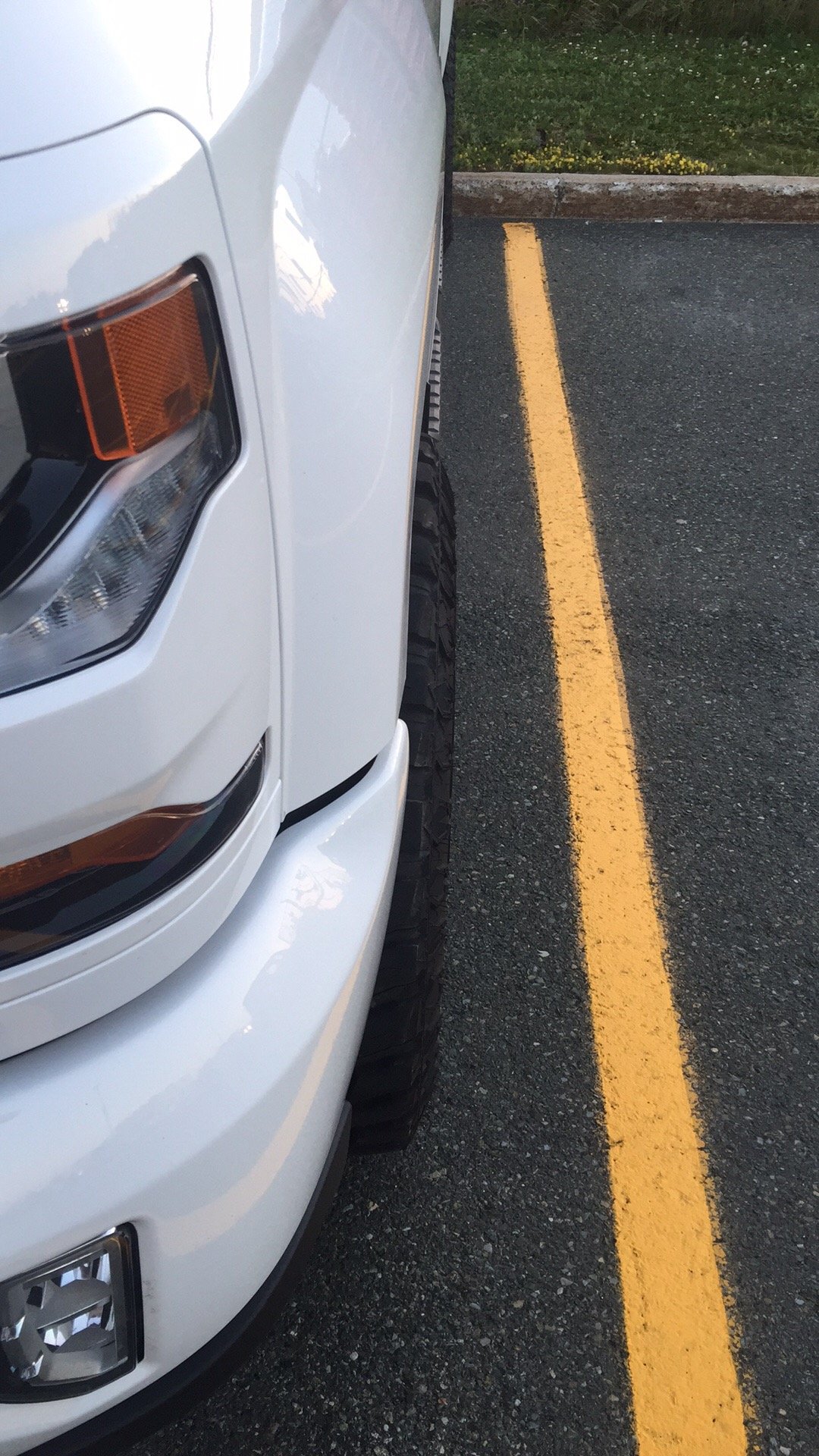

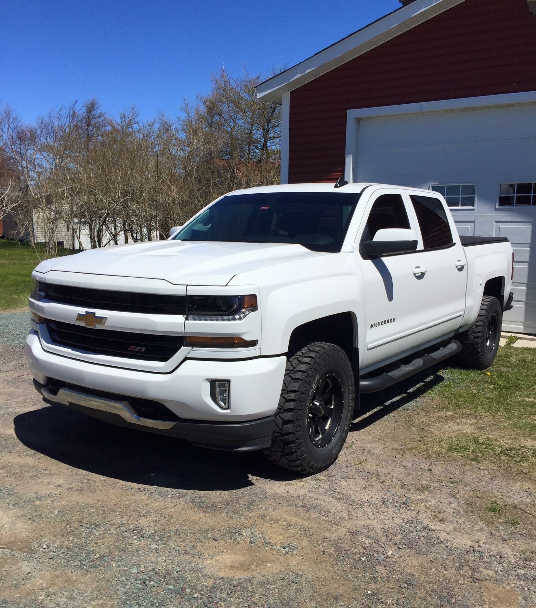

Here's some pics of 285/7017 cooper discoverer MTPs  on 17x9 +6.6 pro comp wheels. Bilstein 5100 all around, set at the highest in the front, and an aftermarket 1" rear block. Crew cab 4x4 2016 LT z71.
