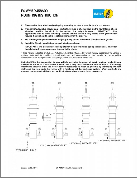

Aaron1085 Posted March 25, 2018 Posted March 25, 2018 Bilstein 5100’s allegedly provide up to 2.5” of lift up front. Is this actually correct?Sent from my iPhone using Tapatalk
FHLH Posted March 25, 2018 Posted March 25, 2018 1 hour ago, Aaron1085 said: Bilstein 5100’s allegedly provide up to 2.5” of lift up front. Is this actually correct? Sent from my iPhone using Tapatalk no.. but it is the best change I've done to this truck since I got it. The Rancho's are pure junk 1
jimmyboy8301 Posted March 25, 2018 Posted March 25, 2018 Bilstein 5100’s allegedly provide up to 2.5” of lift up front. Is this actually correct? Sent from my iPhone using Tapatalk It’s different on each make/model. On the GMs it’s: 0, .75”, 1.25”, 1.85” 2017 Chevy Silverado LTZ Z71 6.2L 4.5" Zone 22x10 American Force Grips 33x12.5 Nitto Ridge Grapplers Instagram @wildchevys
