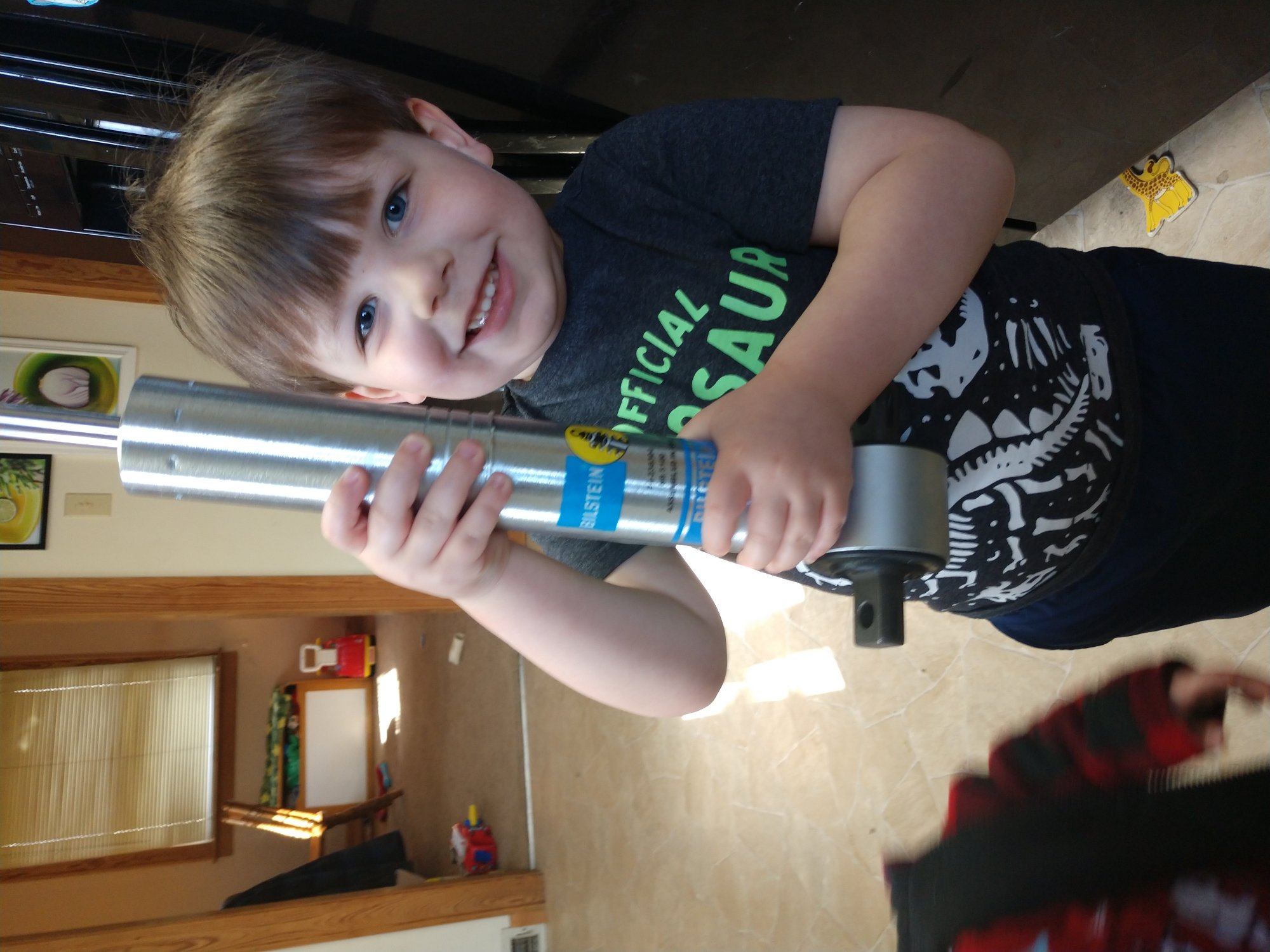

Amazon Prime is a wonderful thing! Got these yesterday, but don't know how soon my helper and I will be able to install them.
Cool! Always thought the 5100 was a nice looking shock. It's a quick ,easy swap. Did mine in about 10 minds per side.. With less than optimal tools. Rachet broke so I was using wrenches.
