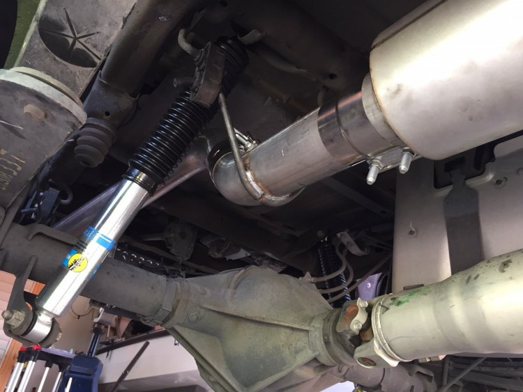

What is the consensus on the rear shocks and their orientation?  Traditionally the protective rubber boot goes up, but I'm reading in this thread that people are installing them with the boot down and the Bilstein logo rightside up.  People are saying this is per Bilstein's installation guidelines.  Is this correct?  I have a mechanic doing the install for me tomorrow and I want to make sure he does it correctly.
Edit:  I've been doing a lot of reading and everything I can find says to go with the direction that has the Bilstein logo reading correctly rightside up....in my case that would mean that the boot is to the bottom and shock body is to the top.  Seems to be in line with what everyone here is saying.

11 hours ago, Silverado-Hareek said:
Well it's been a long 4 years of being cheap and waiting for the stock tires to wear down.  Tomorrow I finally install the Bilstein 5100's I ordered a couple weeks ago.  BFG KO2 tires go on on Monday.  I'm really pumped to finally make this thing look tougher.
