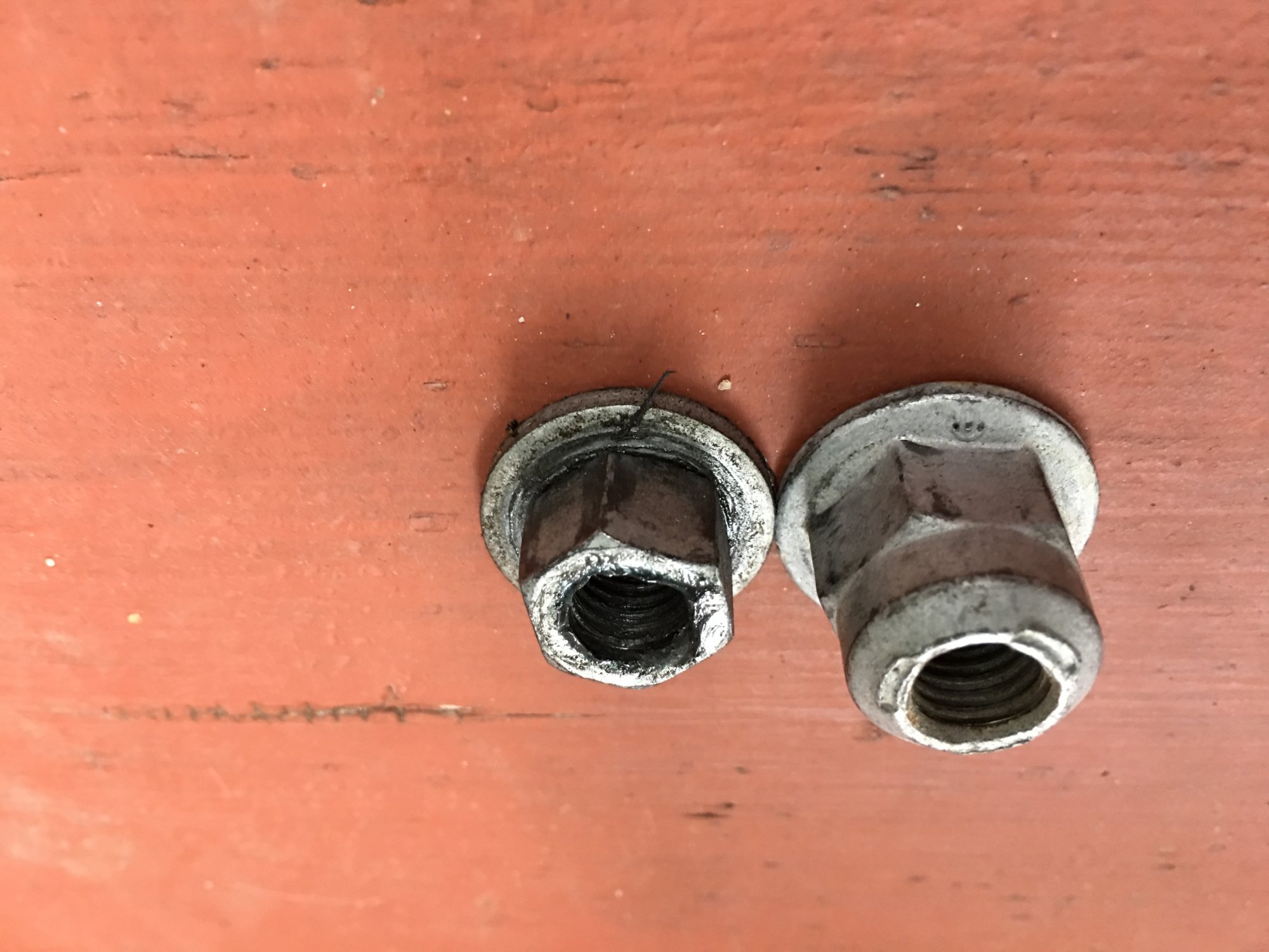

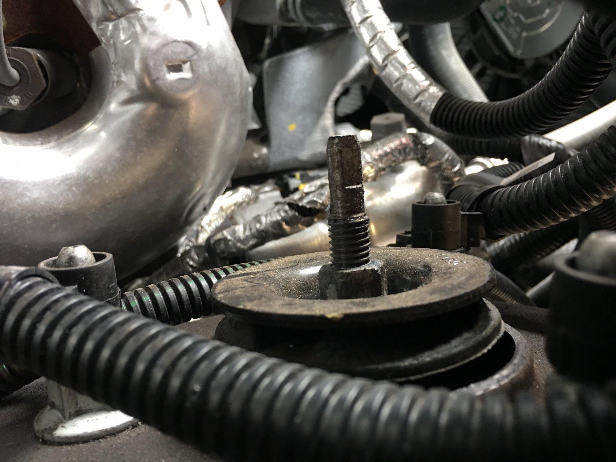

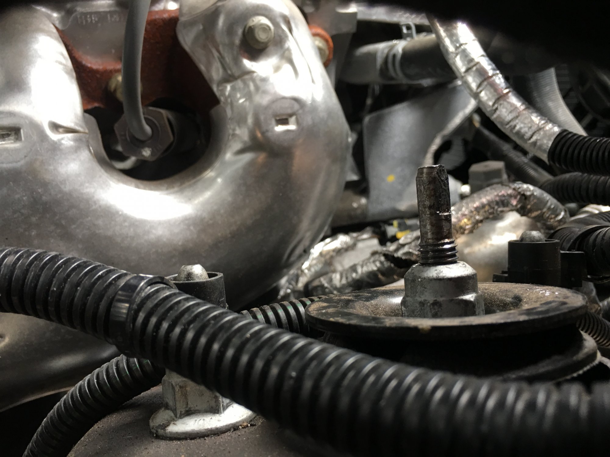

FYI use your stock nuts when installing bilstein 5100. The nuts bilstein sends usually bottom out on the strut rod threads. If you have a squeaking or banging / clinking when hitting bumps, especially after you put some miles on your 5100s.  If you can turn or move the black top hat below he nut then that’s probably the problem.
First pic 15mm bilstien nut. See how many threads are at top.
Second pic stock GM 18mm nut which is deeper and doesn’t need threaded down to end of strut threads. Aka no bottoming out.
Edited by 2009GMC
