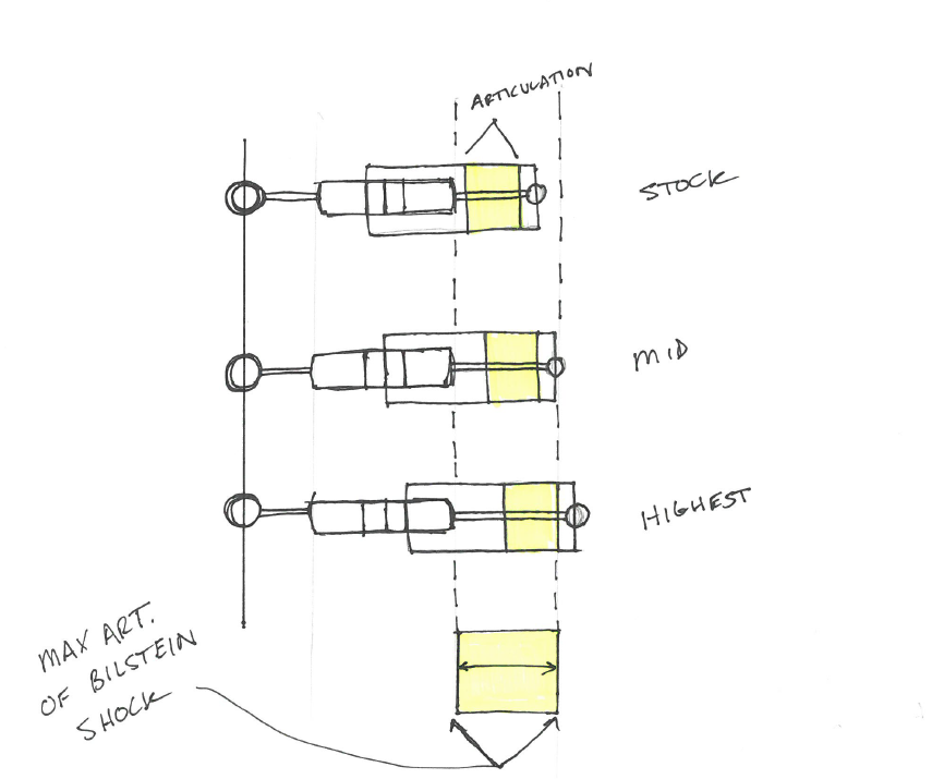

Just now, Delek said:
Hello peeps,
    I'm trying to figure out the best possible setting for a bilstein that allows for the most movement in the shock. Im re vamping my suspension and would like to keep my almost new billys. I will be adding 3" spindles and new UCA. From what I can figure out, in order to get the best ride and the most movement, I will be moving my billys to the middle setting, adding an upper spacer, and then the new UCA to accommodate the additional downward travel. See diagram below. To me, this is how it all works out witht he 5100s.
Lowest settings has no extra down travel, but lots of extra upper travel
Middle setting has some extra down and some extra upwards travel
Highest setting has no extra upwards travel but lots of extra down travel
Seems to me the happiest and most capable position for these shocks is in the middle.
Sorry,. drew the bottom limit dotted line in the wrong place. But you get it.
