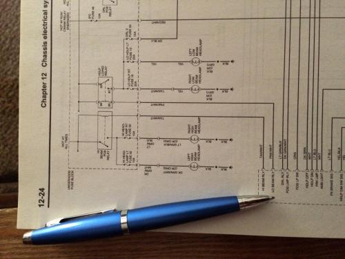

Yep, I found that relay. Not the culprit. Not what I am looking for. I am looking for this one (at the end of the pen)...didn't see these in the owners manual... or the location mentioned of them or the BCM in my Haynes manual.post-145510-0-17299200-1435945449_thumb.jpg
I am having the issue where everything works except the low beam and the DRL. Thought it made the most sense to start with the low beam relay before moving to the switches and BCM, which I am not sure where that is located either.
