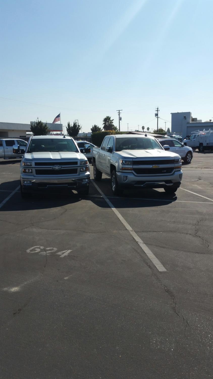

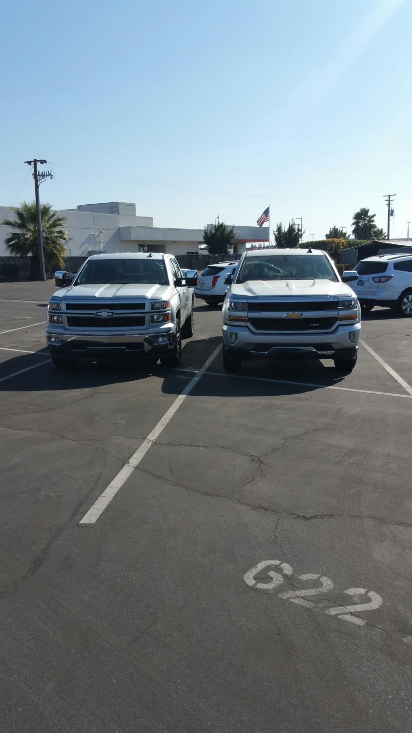

It's just been a few days back but someone posted side by side pics of their 14 or 15 with a 16 model. maybe they will see this thread and add their pics.
2016s have a different hood. I've been looking to swap front ends as well and for what I've seen you need to replace hood, grill, bumper, and headlights.
And that would be me... here you go
