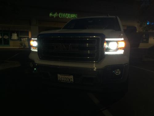

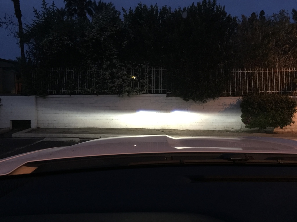

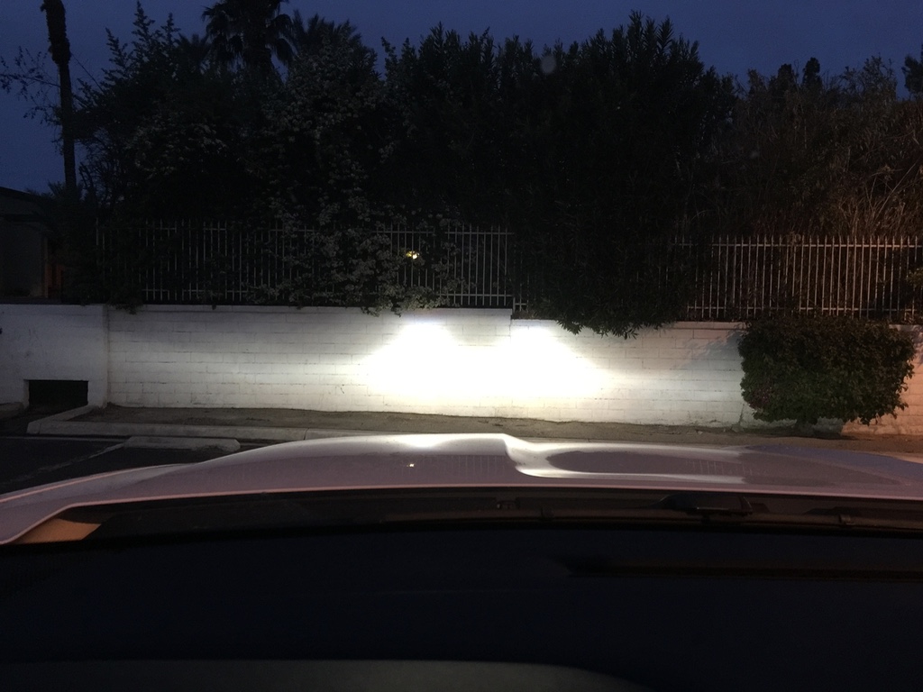

Here are some images I snapped last week. My phone camera is a little deceiving (I think the beam pattern is even better than the pictures), but did the best I could.
The beam pattern is definitely a huge upgrade over my stock 2015 headlights with the Morimoto Sierra Spec kit.
