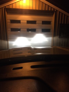

Here is what mine look like at night: post-136265-0-82706700-1481139625_thumb.jpg
