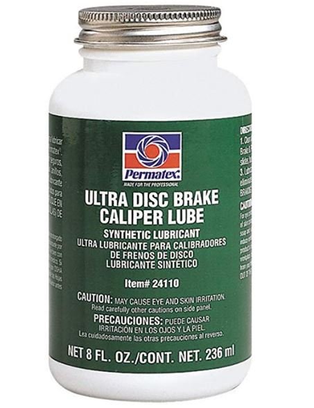

I am not here to tell you what and what not to do. But....do only put silicone based grease/lubricant on brake componets and slide pins etc.  You can and will swell all associated components,bushings, seals etc.
2qty things....Buy HIGH QUALITY JACK/STANDS...and NEVER CUT CORNERS ON BRAKES!
Not to worry, have 4, 2 1/2 ton stands and lubed with this. all synthetic.
