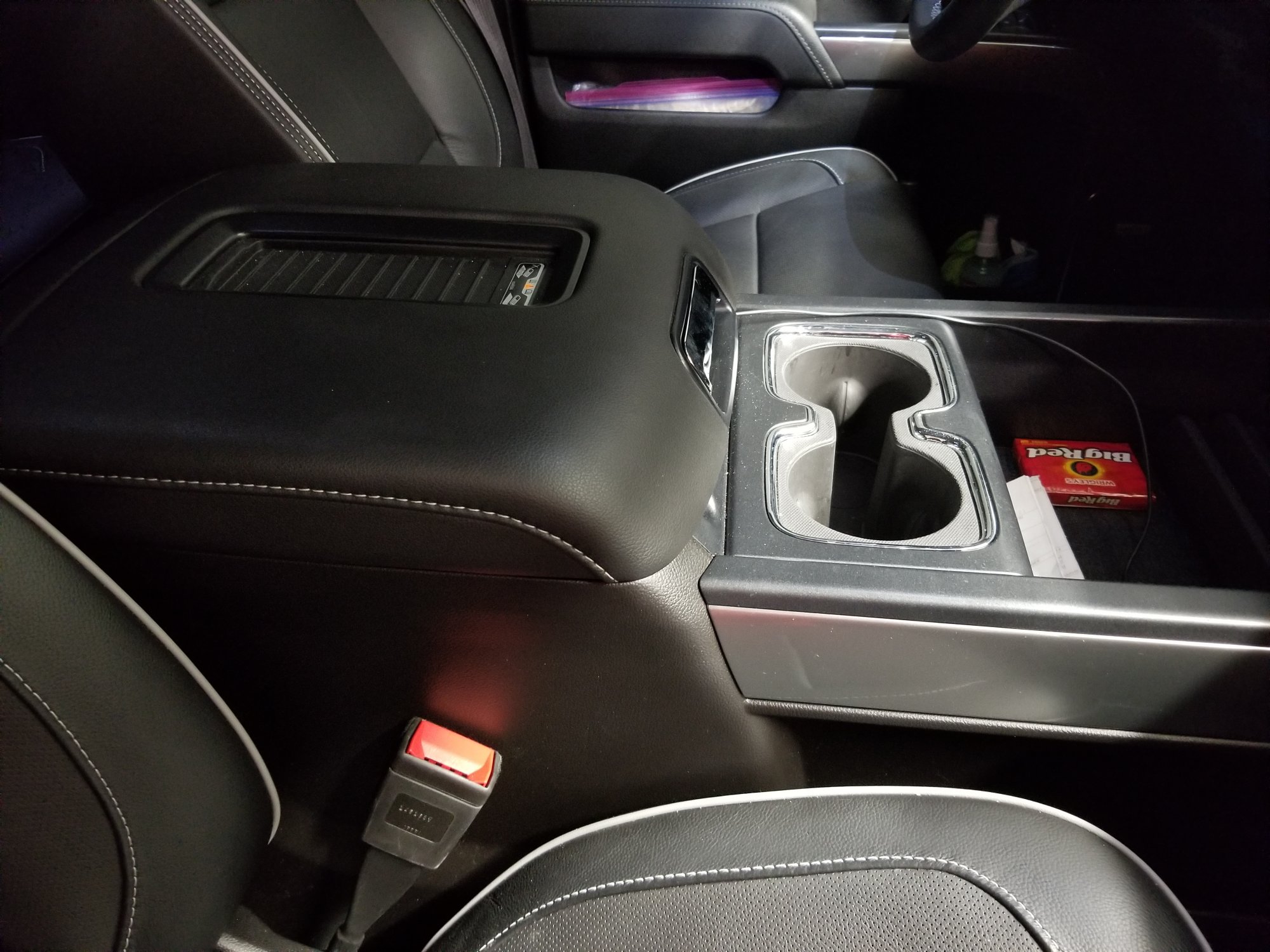

In my explorations on various lids, I discovered that the double white stitched lid I got that came from an SUV console had the smaller mat similar to the ones with modules. This is when I learned that GM made a “Delete Wireless” model of lids. This meant that the studs to accommodate a module were there.
See the video I made on this here.
Lastly,
I have designed a harness that will nicely pull 12V from the rear 12V cig lighter outlet for $45 that will plug into the lid with the 2018 module.
Looks like this.
One final thought on this...
I picked up a lid from an Escalade Console. My iPhone XS Max (with an Apple leather case) fits the mat! So naturally, I placed them side by side and it looks like a direct fit.

Phil, what year is Escalade console lid? Looks like a great idea! Should be plug and play for my 2018 console?
thanks again!
I find the wireless charger pretty pointless.  Yes, it works in my '18, charging my wife's S7 Edge and my G7 ThinQ.
But it's pointless, since to use Android Auto you have to hard wire.  If I'm pulling my phone out of my pocket, I'm just going to plug it in there.  OEM's aren't offering wireless Android auto quite yet (it is available in Android, so in 2-3 years Apple CarPlay will have it and Apple Fanboi's will tell you that Apple invented it).  Once OEM's adopt the wireless Android Auto, then the wireless charging makes a lot of sense.
I had it in my last truck as a wireless charging cell phone mount, but that was so I could see the phone as it didn't have Android Auto.  That made sense - in this truck, pointless.
thanks again!
It doesn’t have the latest module.. so I’m guessing 2017. When I get time, I’ll throw the 2018 module in it and test it. I use a cable myself and a mount, so having wireless charging are for those times I just throw my phone on the lid.
