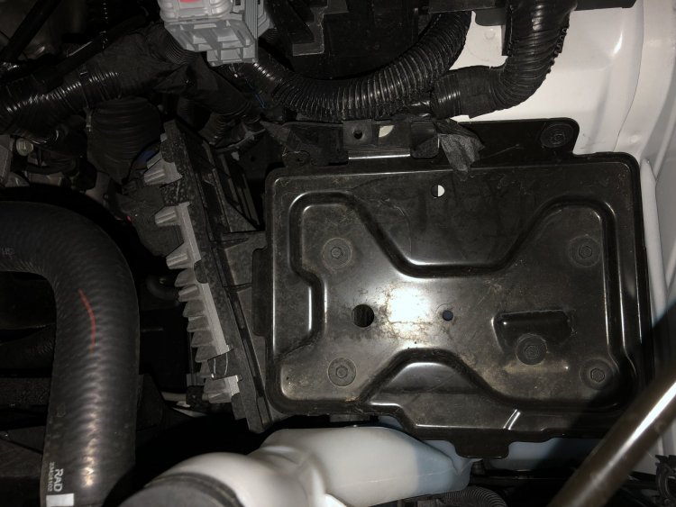

Is this the correct tray to add a second battery then? it doesn’t look to be but the the part number for my 17 doesn’t match what was on here
Edited by Sloverado
I believe you would need part number 22989633 for the correct battery tray and the tie-down

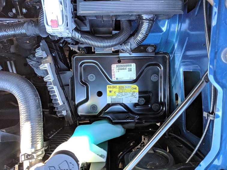

On 10/23/2018 at 3:57 PM, csoldfield said:
I can confirm 22989633 - here's it mounted in my 2017 Silverado
Super Clean Install!  Love it!

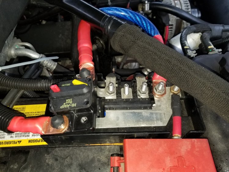

If you wanna go completely factory for the second battery, it's alot of work. When i did mine, i made my own cables. The routing is totally different. I just went from + batt1 to + batt2. I also did + from alt to + batt2.  - from batt2 to engine and chassis. All of my aftermarket stereo power gets power from batt2.
Edited by RACERX7775

This just shows the breakers from batt1 to batt2.20180519_170215.thumb.jpg.58dc03ed80ef652a0f5ce6984ce2f6e5.jpg
That means you just have a bigger single battery system. Also the charge system doesn't know the difference and also you can hurt both batteries. Been there done that.

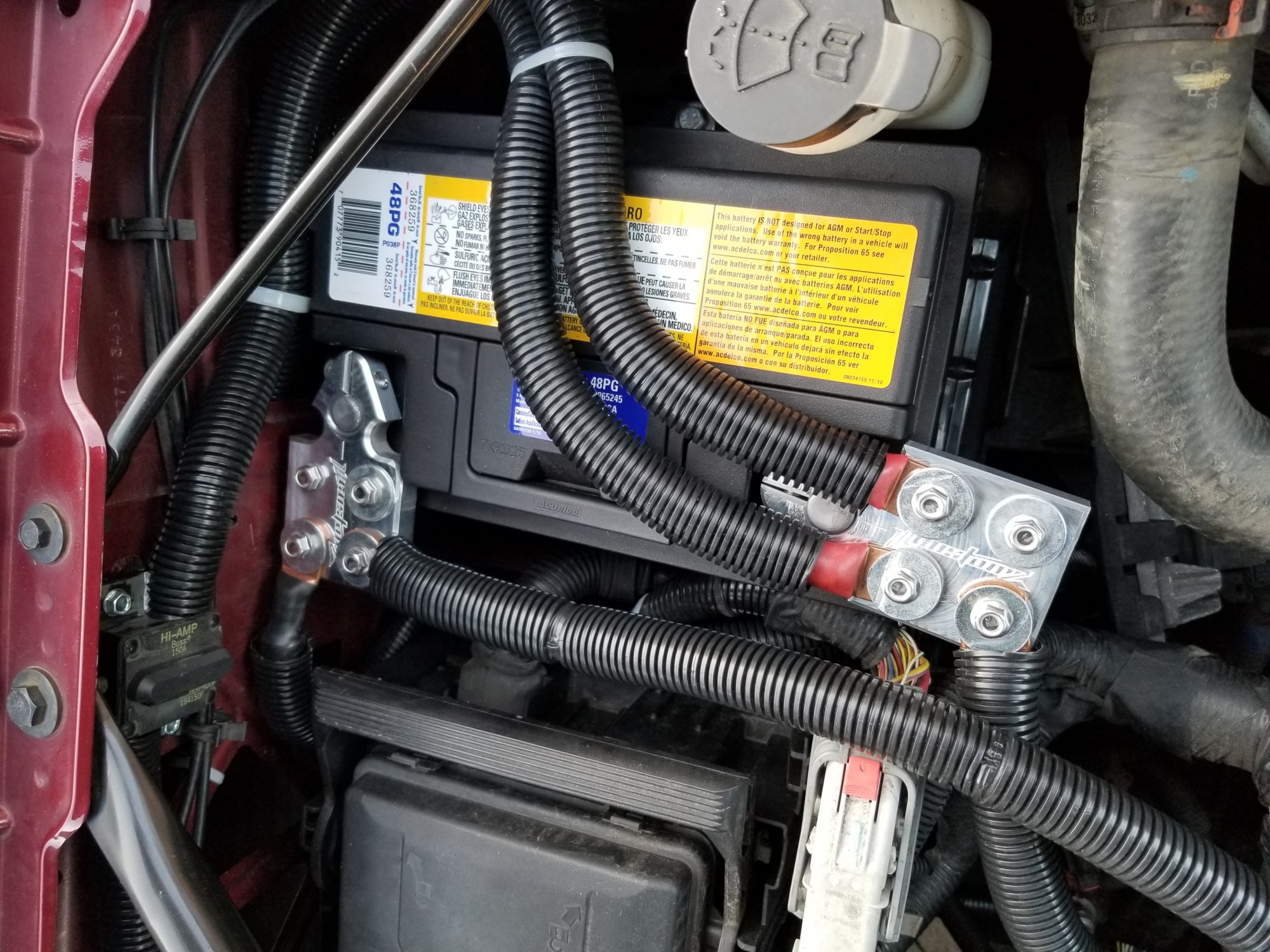

Battery tray isn't needed the factory tray works with some batteries and with Optima batteries as they come with the adapter. All you need is the hold down $7 part. I did this on my truck and posted pics.
Are both grounds going through the battery current sensor? If not youll run into high charge issues

Without a isolator then when the truck dies both batteries are dead. It will not start. Also one battery goes weak and the other will suffer. Charge system will have a hell of a time.
Sent from my SM-N950U using Tapatalk
I wasnt looking to isolate either of them.  It was more of a way to keep voltage spikes at a min from the stereo system. This isnt my first time doing this thing.  If done right, you wont hurt anything. I had these in the back of my excursion with 2 more up front.
