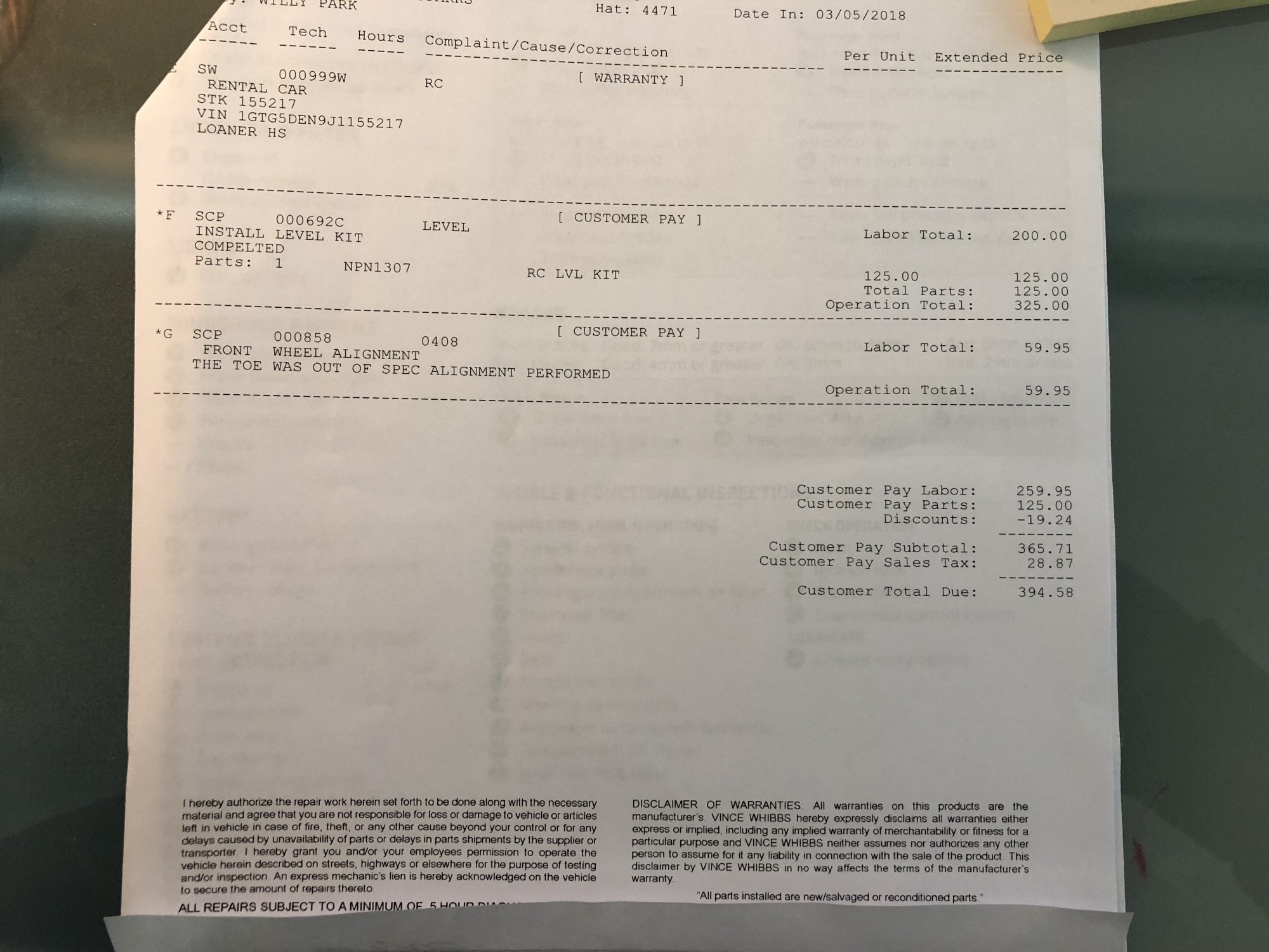

$394.58 out the door with alignment, WIbbs GMC in Pensacola.
Is that $394 including the parts or just the install? Thx!
That was for everything, parts/labor/tax.  The dealer keeps the kit in stock, and told me they do them "all the time".
I haggled a little, they added about $20 in "shop charges", so they took that back off and also gave me a 5% mil discount with my retired ID.
Honestly, I don't think it would be worth more than $400,  at least not to me.
