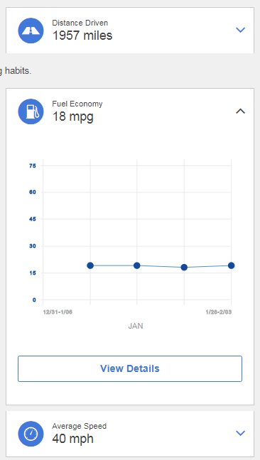

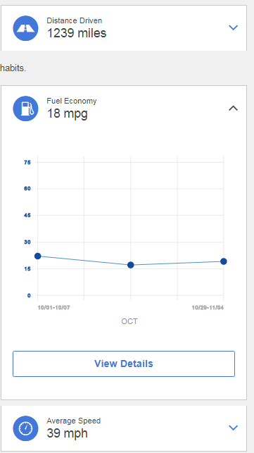

My GMC really didn't change much at all when I changed to 285/55R20 BFG KO2s & the 2" level kit.  Here's some info from last Oct. before I did my level kit and again in Jan. after I did the level kit.  Both months were heavier than normal mileage for me due to a couple road trips both months.  I usually drive less than 800 miles per month.  Onstar reports the very sim. numbers for both before and after months.  For the record, Nov ave. was 18mpg, Dec was 17 mpg, and I'm at 18 mpg for Feb.
