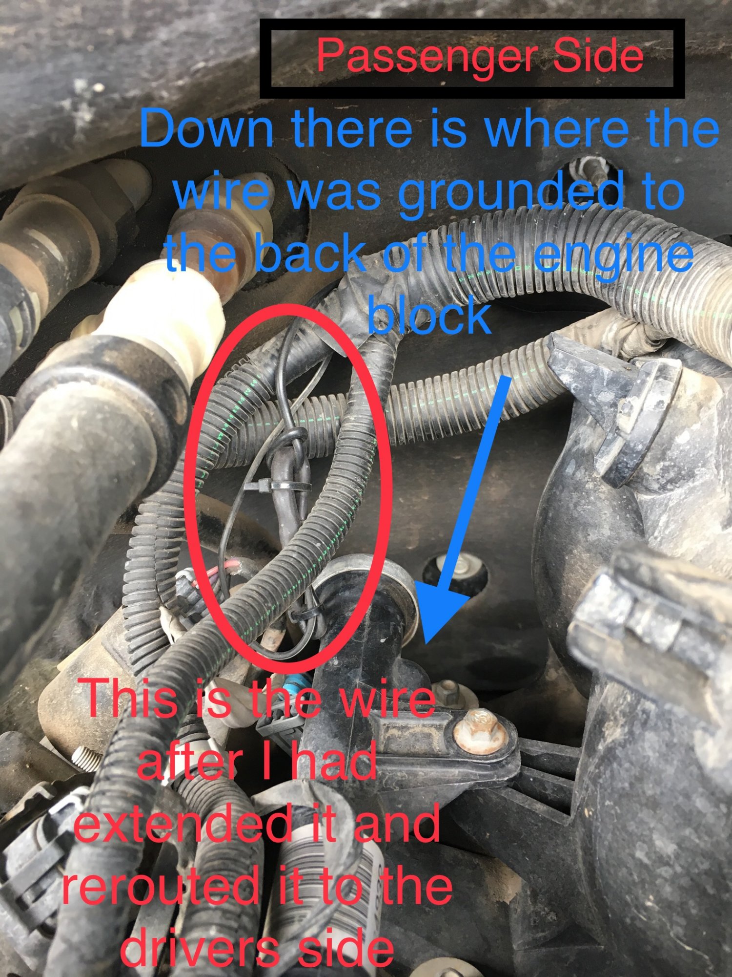

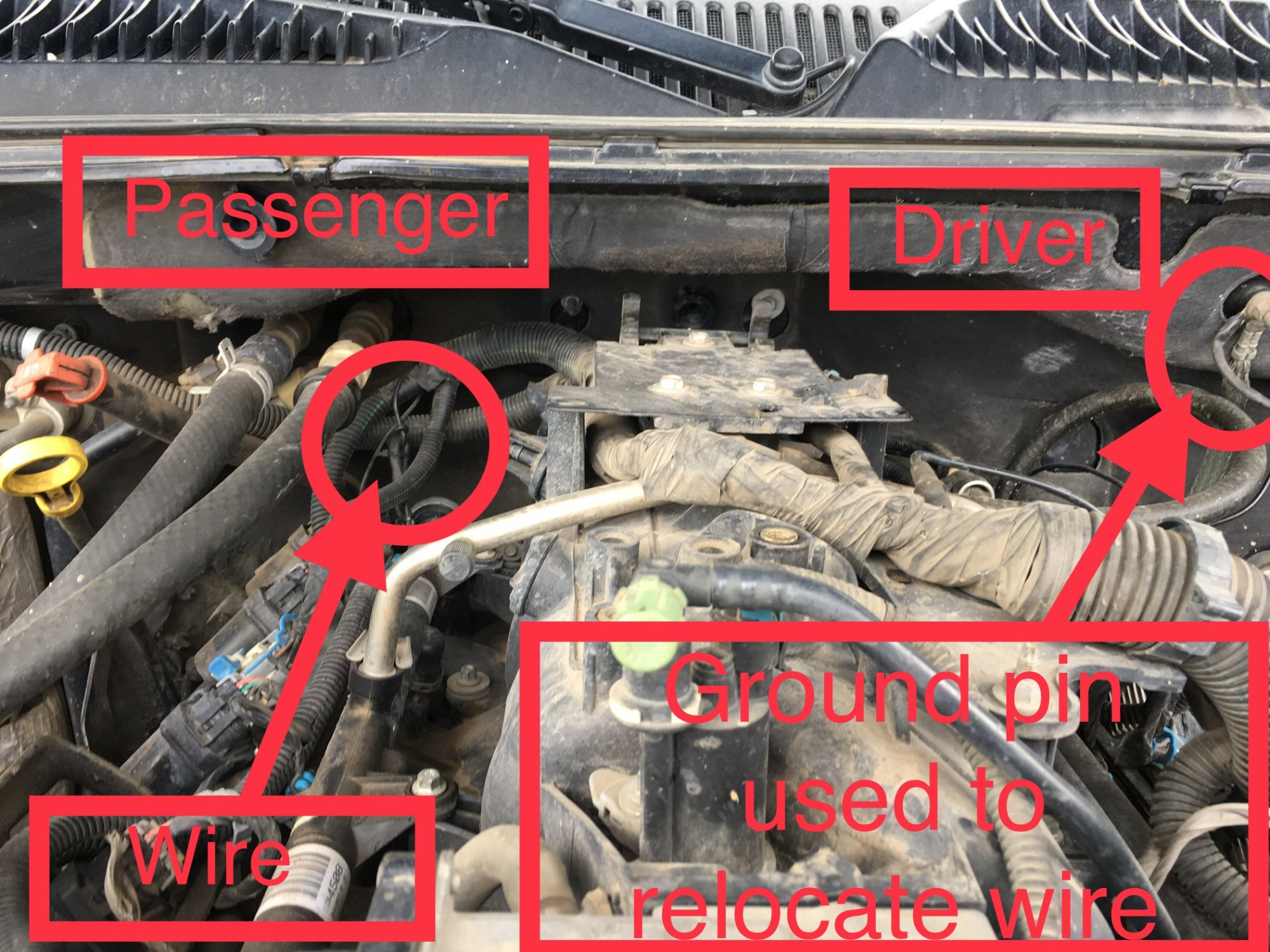

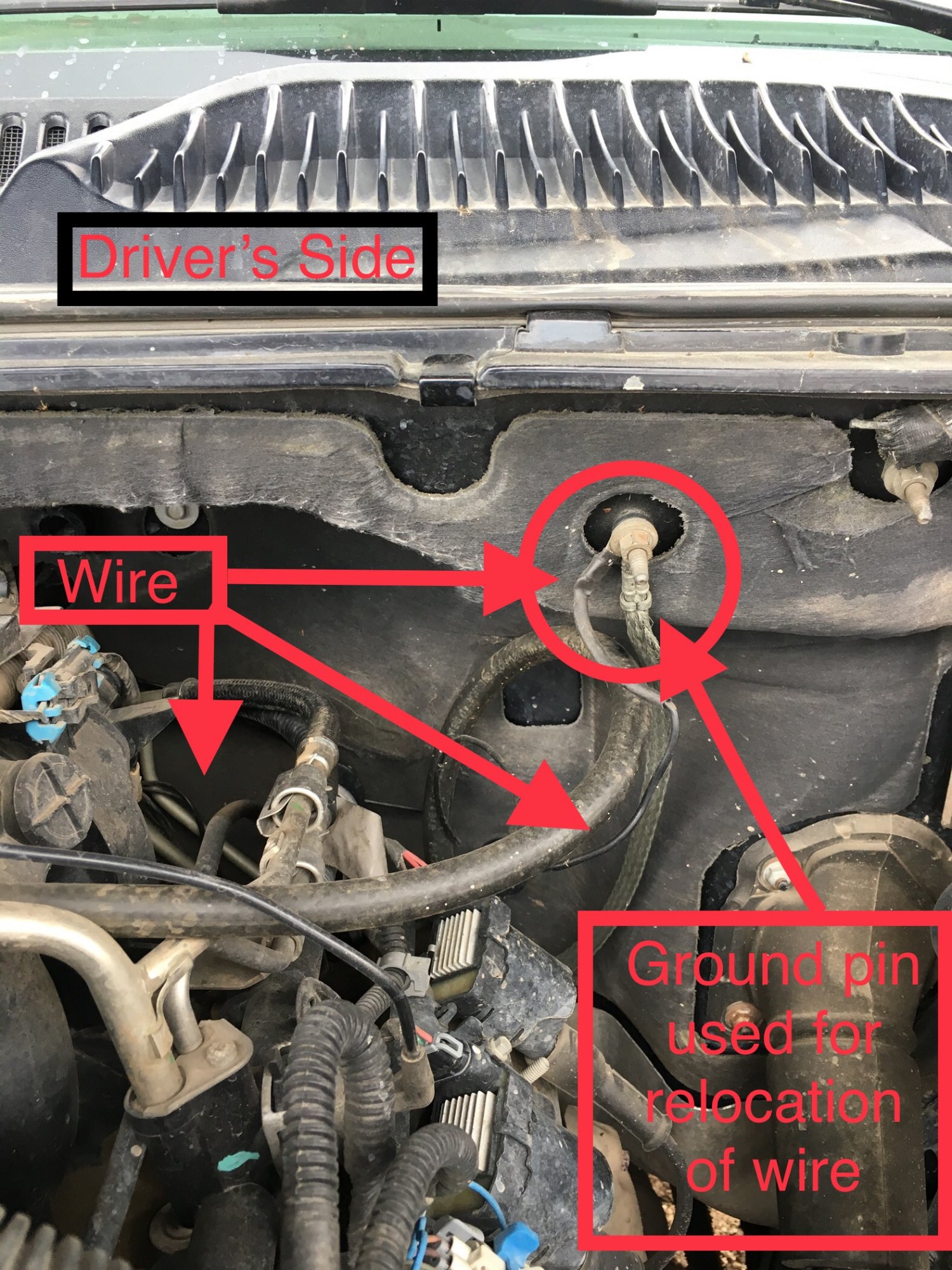

On the back of the engine block passenger side coming from the main wiring harness on the fire wall will be a single ground wire that goes to the back of the engine block it’s kinda hard to get to and harder to see but the connector is damaged or loose and is causing your issue undo the wire and relocate it to the ground pin on the fire wall that has the braided ground strap coming from it this will solve your issue for sure it sounds to simple but believe me it works have a great day

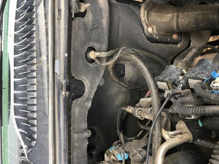

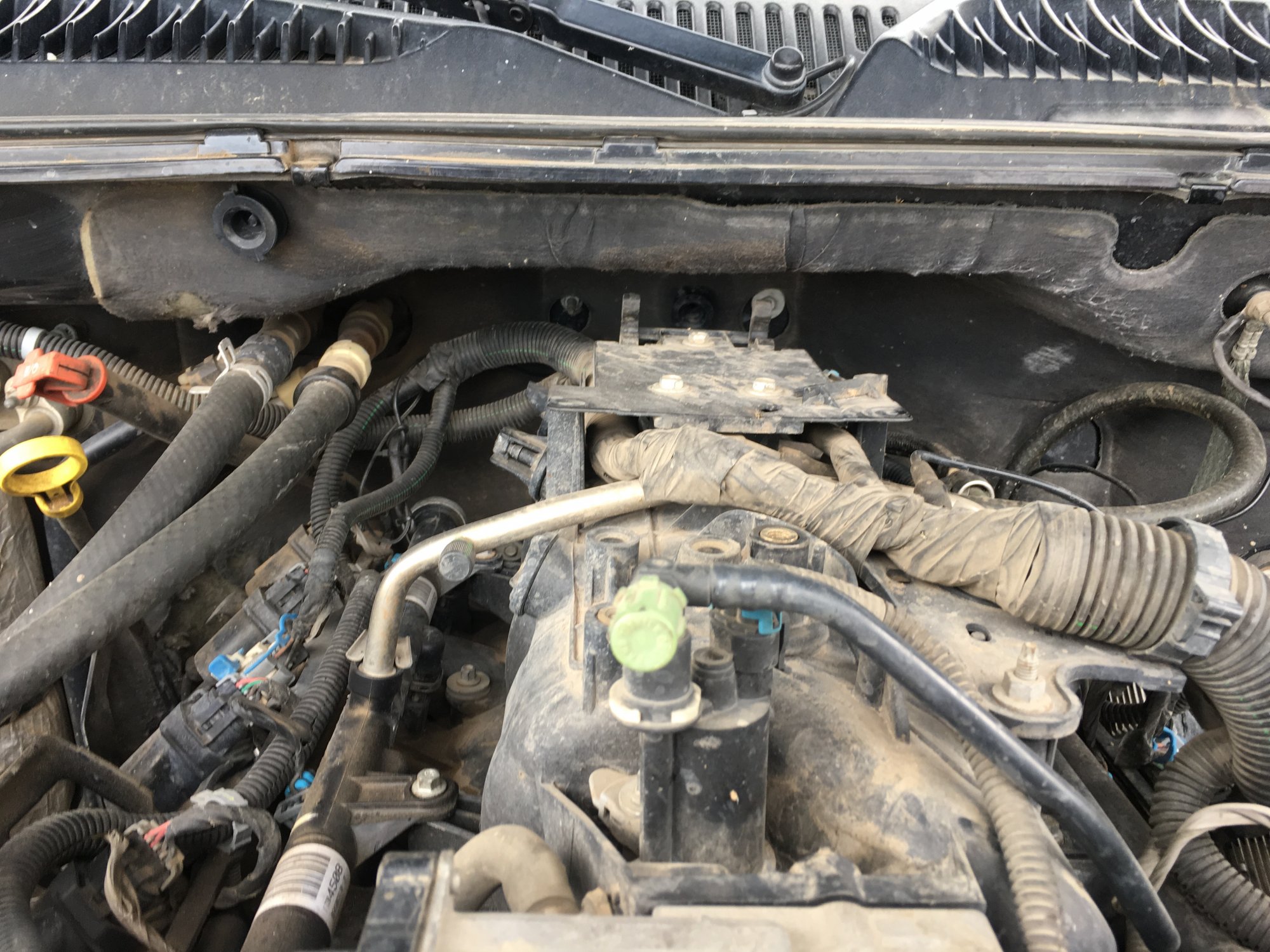

I posted original photo then photo after I marked it up couldn’t get any good ones of the bolt on back of block I’ll try again though if this doesn’t help
