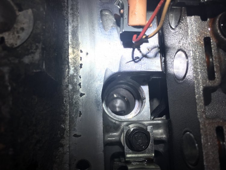

Could you take a picture of the little bits of seal left in the pump body? It sounds like it won't be an issue, but it would be easier to discern with pics.
Thanks for the response. This is exactly what I thought as well, because the actual filter part like I mentioned is much more 'low profile' than the original. I am going to take it back tomorrow and hope they have the right kit. I will try to get some light up in the hole and take a picture tomorrow.

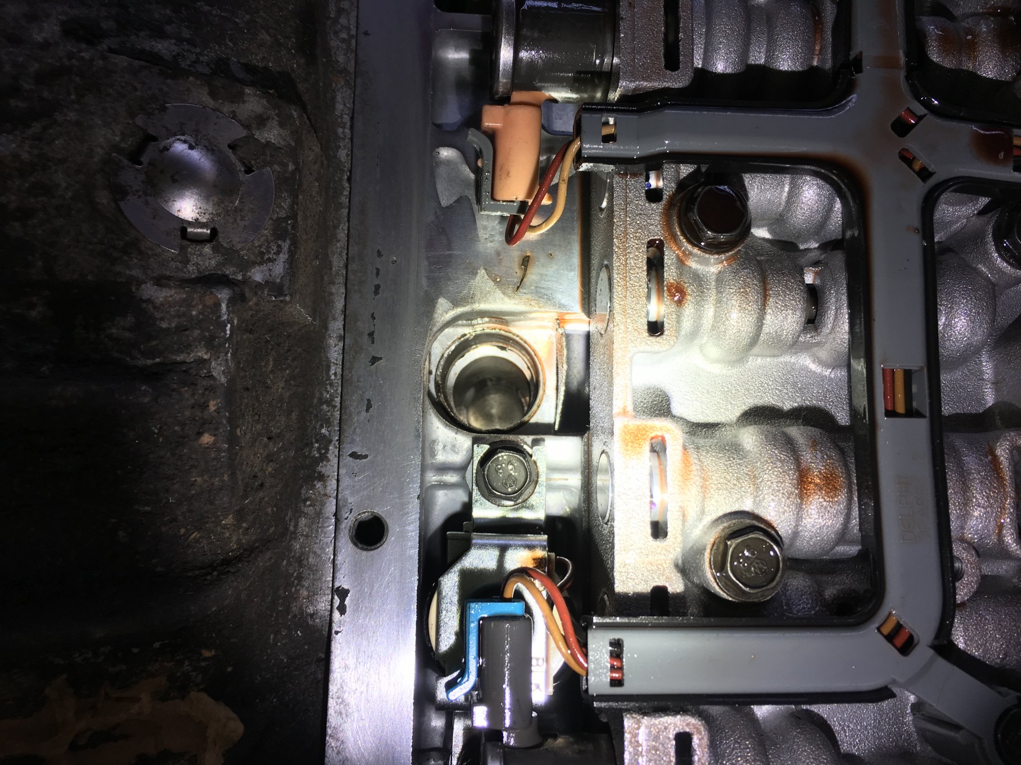

So my father says he still thinks that metal ring is in there. It sort of looks like there still could be something from the pictures. The seal that came out was pretty much complete but it was all rubber unlike the new one. You guys still think something is up in there?
So the whole metal portion of the seal is still there. The seals on these are rubber coated rings of steel. You have 2 options for getting that ring out now (you have to since you peeled the rubber off of it.). First, a sharp chisel to nick the edge and fold it in on itself and then grab it with a needle nose pliers and pull it out. The second method (which I am a fan of) is to get a 1/2 or 3/4 (I can't remember.....take the new seal and match a plug to that) NPT (pipe thread) plug from your hardware store/ parts store and thread it in as you would a bolt to the point of nearly bottoming out. Then grab the end of the plug and rock/ wiggle it back and forth and it should pull right out. Hopefully this works for you.
Yes/ Metal part of the seal is still there. Do as described above or as Nick showed.
It's 1/2" NPT that will work
If you look at the thread I posted. I just used a small screwdriver to collapse the seal inward, then I was able to pull it out with the pliers.  It isn't very hard and will bend in easy.  Just take your time.
Thanks for all the replies gentleman, as always it is much appreciated. I already took a screwdriver and tried to gently tap it inward with a hammer. I had no luck in doing so. I might give it another go but I do like the pipe threader idea for sure. So I went to Advanced Auto and they did not have the ACDelco one in. So I went over to AutoZone, nice people but did not know what I was talking about. He brought out the same thin filter with the metal bottom and told him that was not it. Then he came back with this one. The little sticker on the cardboard says ACDelco on it and it definitely looks identical to the one I took out.
So for better or worse I got sick of dealing with the seal and I took a pick with a dull end and just drove it up in there. I bent the seal and tore it out with a pair of pliers. However, you can see where I put an indent into where the hole starts over to the right side of this picture. I got the new seal on and it looks good. I think worst case scenario some fluid will leak through and evade the new filter. However, no metal shavings of anything are likely to get through. Also the actual part of the seal that does work is around the top and it looks like that is pretty good still so I think I am good to go.
