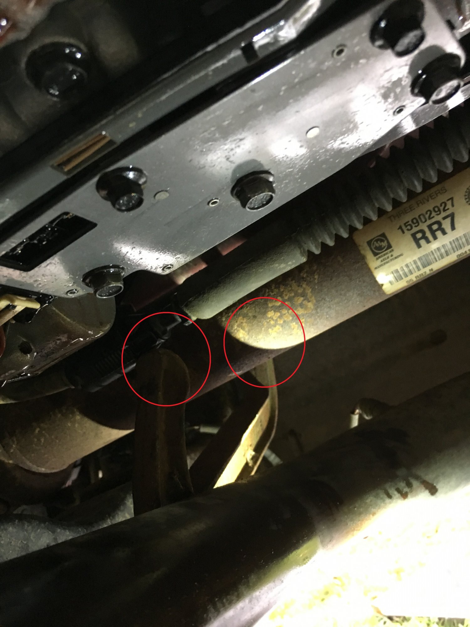

Not sure if it is a big deal but a couple of these gray plastic wrapped around the screws are broken. It looks like there only purpose is to hold the wiring in place and it is still pretty secure. Not going to lie, could have very well broken them getting the pan off.

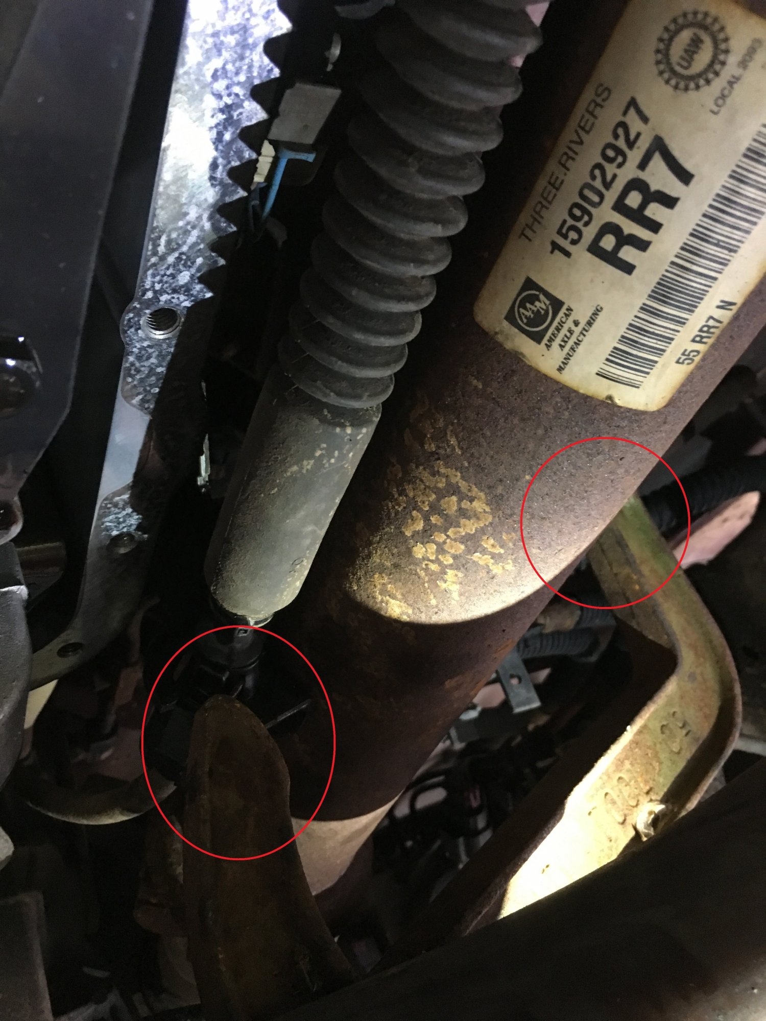

I was able to pry away the shift linkage using using a C-clamp. I know it is hard to see but it is on the tip of the bracket that holds the shift linkage in place and on the other side of the front drive shaft.
This is again difficult to see, but gives you a different angle. This worked pretty well, but did have to pry the bracket that holds the shift linkage a good deal away. It was pretty close to touching the front drive shaft before the pan would come out. Also the drive shaft kept wanting to turn while trying to secure the C-clamp.

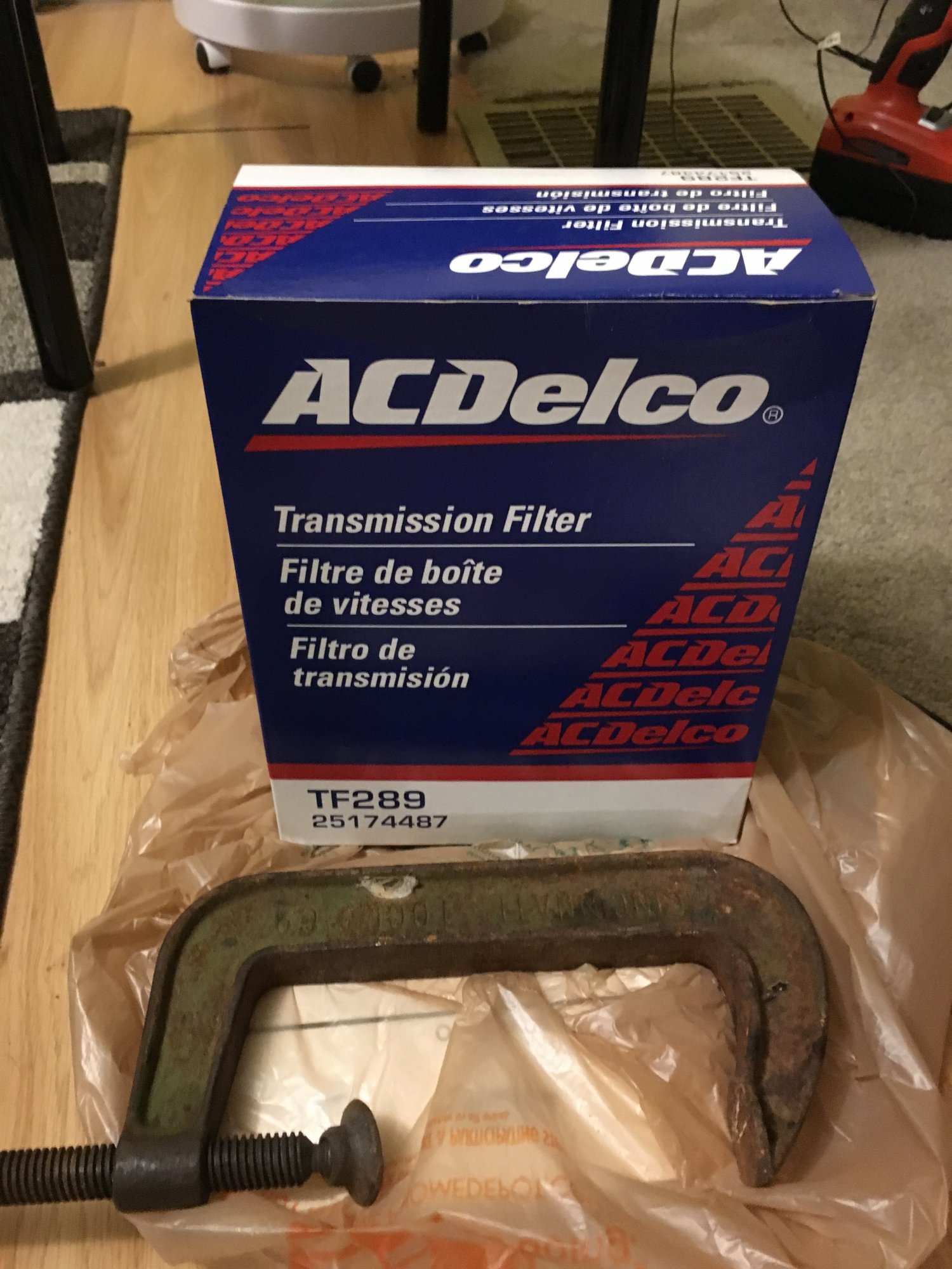

This is the C-clamp I used and the box of the new filter, gasket, and seal. I will let you know what size it is when I figure it out myself. The first one I tried was too small. I do not think I can do any real damage this, way as you do not need to put a lot of pressure on the front drive shaft to get the bracket that holds the shift linkage to shift over. I decided to go ahead and take it off though in fear that it might do damage if I do not get to it for a couple more days.
