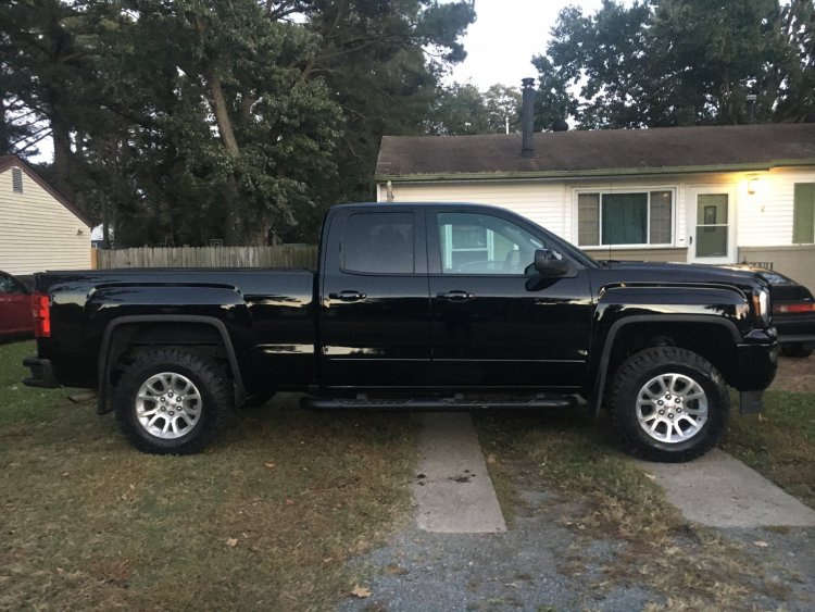

My local dealers could get 285/65/18, but after talking to BFGoodrich I learned that in September they released 6 DT sizes of KO2 that come with a with a 50,000 mile warranty but loose their severe weather/snowflake because the tire compound was changed.  The only 18” size they released was the 275/70/18 DT = 33.2”x11” (my buddy put the 275/65/20 DT KO2 on his 2016 f250 last week)   I have put 45k on my 2017 Sierra 1500 in the first 16 months, so I will find out in the next 16 months how this new compound works out. On to the pics (2017 Sierra 1500, 275/70/18 DT KO2, motofab front 3” upper and lower level kit, motofab rear 2” level kit) before and after:
