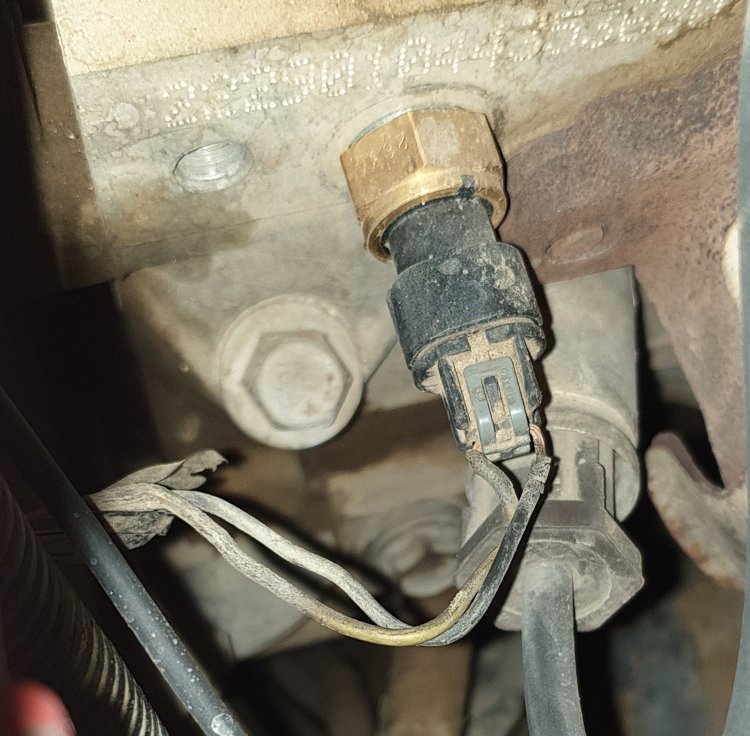

But I'll have to note that the coolant temp sensor cable looks so thin and fragile, could it be that it's sending a wrong reading when the engine is accelerating?

No I did not lose coolant before, and no, there's no white smoke or milky oil. I've had mild overheating problems with the green coolant, but nothing that stopped me from driving the truck. I've posted a picture of the wire above, do you say it could cause all of the problems I'm having? I can see some exposure near where the wire meets the plug.
Well, since that is a thermistor circuit, a short circuit would show overheating temps, whereas an open (high resistance) would show cold, so if you suspect the wiring, I'd look for pinched wires somewhere. Also, I re-read your first post, and you mention that the gauge goes just above midway. Could it be that there's really no issue, or do you think it's still overheating?
Well I bought a new wire with a pigtail that I'll install tomorrow, and I'll see if that fixes my problem. Whenever I need to push on the gas, or the car has to go up a hill or downshift, the gauge goes above midway, and I can hear the fans kicking on high but then turn off after a minute. And then the car gets seriously hot and lose all its power. The car behaves normal in traffic or idling, but whenever I'm seriously driving it the temp suddenly increases, fans go on high then turn off, and then the car gets seriously hot because the damn fans are off.
One thing I noticed is that when the fans turned off while it was still above midway, I fiddled with the lousy temp wire, and then the temp gauge suddenly decreased without the fans even coming on. I'm no coolant expert, but I don't think coolant can become colder suddenly in a running car with no fans.
