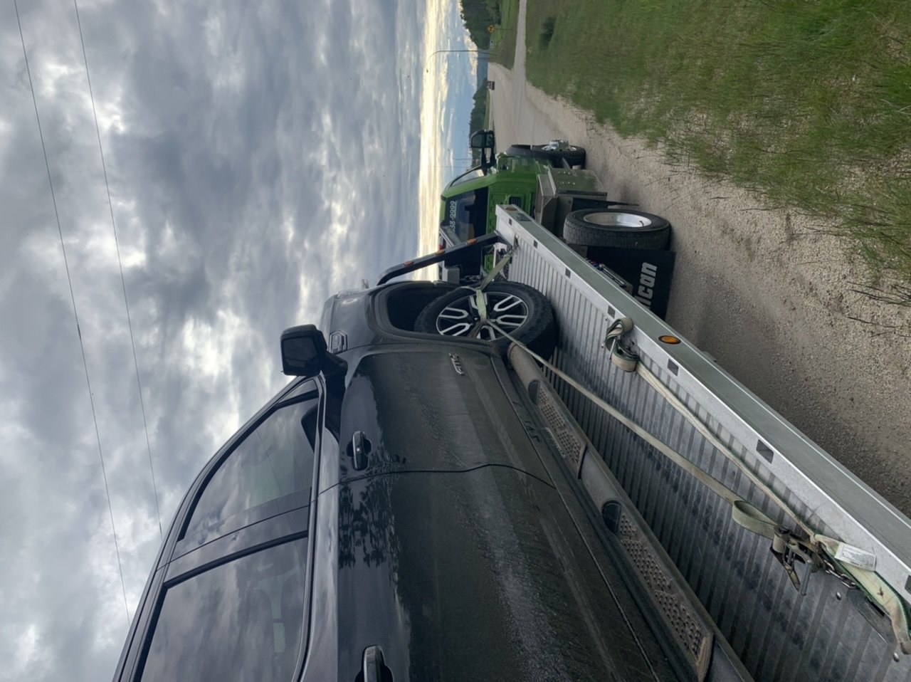

For all you guys in here with levels without new UCA’s. I’d be careful, 10,000km later (6000miles) the front end took a beating.
The ball joint completely separated, dropped the UCA on my tire and wrecked the CV axle. The left side needed a ball joint replacement as well. $2500 later it’s fixed and back at factory height. Looks like a car again (Use to have 34” Toyo MT’s with the level). Time for some 275 or 285/65 Ridge grapplers and I’m calling it a day unfortunately.

The same thing happened to me. I have a 19 trail boss and installed the Moto fab 1.5” front lift. The ball joint on the right front upper control arm broke after about 15,000 miles. I replaced it and kept the lift on and about a month later the left side ball joint broke. So I removed the moto fab lift. Good thing both times it broke I was going slow I would hate to have it happen on the road.
