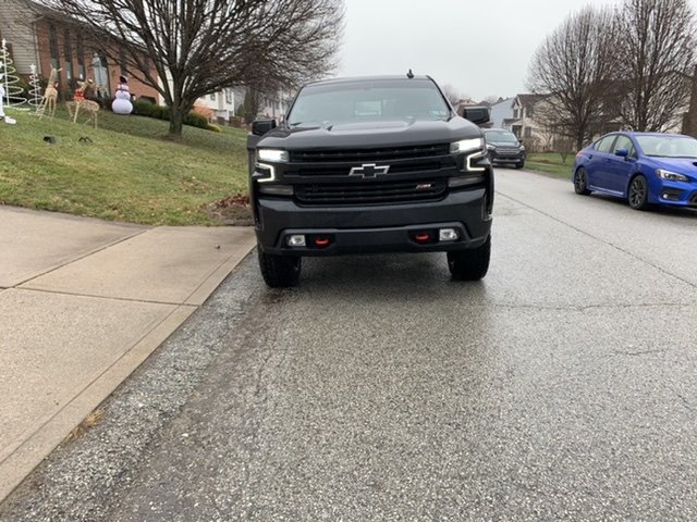

Here are some pics of my buddies AT4 with no leveling kit just 33x12.5r18 Toyo MT tires (actual factory specs 33”x12.7”). He said there is 1/2” gap between tire and balljoint. That is pretty close but his tires are wide compared to others such as the Mastercraft MXT 295/70r18 which measures 34.25”x12” or the 295/70 Toyo Mt which measures 34.5”x11.8”.
He said there was no evidence of any rubbing. Its mainly a city/highway commute truck and occasional beach [emoji907] trips.

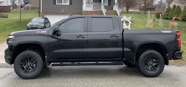

1.75” Ready Lift leveling kit installed. Also has the wheel well trimmed to eliminate rubbing with my 35x12.5x20 KO2s
Thank you for the update and pics, looks fantastic! Any rubbing on UCA’s at full lock? Any chance you could post pics of the trimming you had to do? Your previous post mentioned spacers and ready lift control arms - did you install both UCA and spacers, or just the level?
Thank you!
will post closeup pics of trim job tomorrow.
I did install the Ready Lift UCA
 with their 1.75” leveling kit. I also installed the .375” bora spacers, which were definitely needed as the new arms moved the ball joint a tiny bit closer to the tire. I was already cutting it close.
no rubbing on the arms at all with this setup.
two pics below. One with the OEM arms before the level - without spacers.
The next pic will show the distance with the level, new arms and .375” spacer.
something to take note of. The OEM UCA ball joint has a sharp edge that points towards the tire, so if the tire made contact, it would not be good. The ready lift ball joint is rounded, so if there was minimal contact for whatever reason, I don’t think it would do much.
Hard to tell from the pictures but I had like 1/8” of space with the OEM UCA. I think I Have about .375” of space now. I think I would REALL have to get wild to see any rubbing on the ball joint now. Even if it did rub, it’s round like I mentioned earlier and I couldn’t imagine it hurting the tire.
