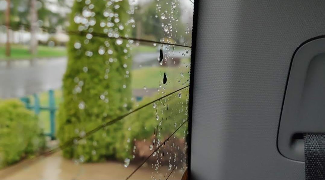

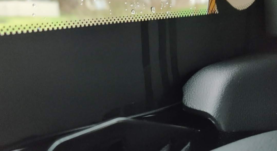

Hey all,
I came across this thread on accident a while ago. Thought I was a lucky one, but after having a series of other issues with my truck, I went out to my truck with a flashlight, and sure enough 2 basketball size water marks on my headliner and water streaks down my window. Well, truck went to the shop for 28 days getting everything fixed. Dealer explained it was my brake light and spoiler leaking. So they pulled those, resealed, removed front window to replace headliner, replaced all damaged items in the cab, and caulked my rear window. Picked up 2 days ago, and first thunderstorm and its leaking again. Fun icing on the cake is as I was driving today after seeing the leak and the check engine light is on yet again which is another ongoing issue. This truck is teaching me a lot about patience, although for me this is now the 9th time it will be in the shop in 6 months of ownership, a total of 45 accumulated days that its been in for repairs, and the 3rd repeat repair issue I've had that wasn't fixed the first time. Give your dealers a chance to make it right, keep things in perspective especially in these times. Although for me, Im needing another solution as enough is enough.

Here’s a fun one. Had rear window sealed, started leaking again, in the process messed up the sun shade, so now they have to replace the whole sunroof track and drop the headliner. Replaced a panel they scratched and messed another one up in the process. Horrible horrible work by the dealer, almost comical at this point.

Ive been tracking this thread for some time.  Had my truck in today for this issue.  Not leaking a ton but more water than I want in my truck.  Service guy is telling me its the 3rd brake light.  He said that there was a TSB on it.  I dont recall reading much on the third light.  Just the spoiler getting recaulked and windows.  Maybe he was mistaken but it sounds like your dealer told you the same thing.  I am not holding my breath on this but I will play their game for now.
