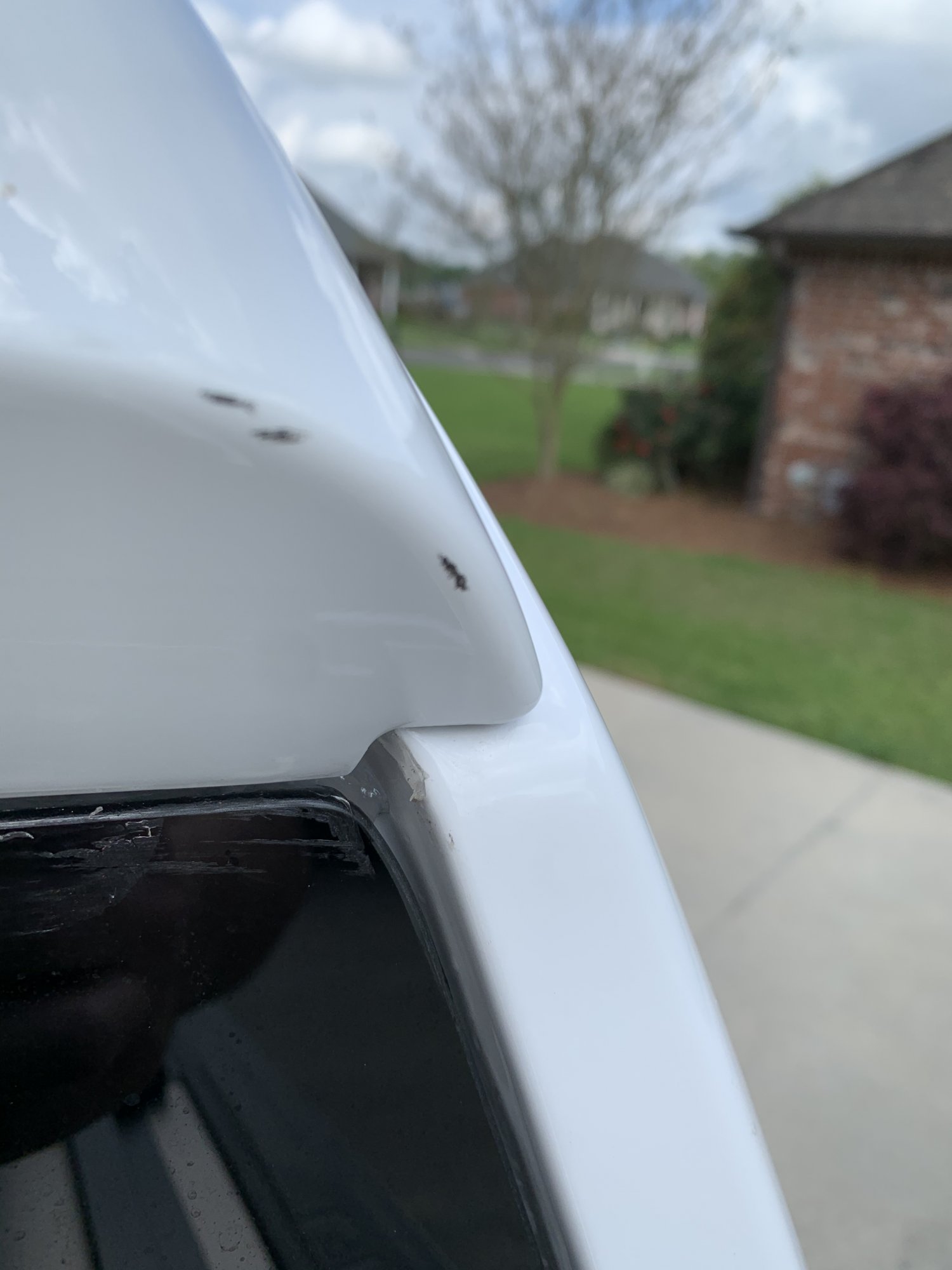

I was washing my truck a couple weeks ago and noticed a small leak on the driver side of my back window. Took it to the dealer and they “fixed” it. Got silicone all over my rear window and bed cover and scratched the spoiler when they removed it. Luckily, they didn’t mess up the interior of the truck any. And the window doesn’t leak anymore (yet). So I complained and they told me they would fix the spoiler and clean the job up but I ended up buying a new painted spoiler on eBay and just replaced it myself. Cleaned the silicone job up while it had it off. It sucks when you can’t trust a dealerships work.

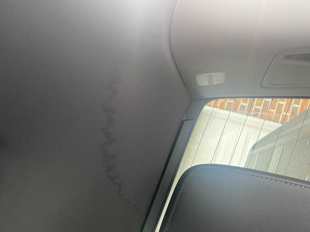

So in the process of replacing my headliner because of water staining from the rear window leak, I now have a leak from my front window... Apparently the front windshield had to be removed to replace the headliner. Oh, and my rear window is leaking AGAIN!!! My dealership has tried to reseal the original window, then the entire rear window was replaced, then the new rear window was resealed, and now I've discovered the leak yet again. I'll be calling back my Chevy corporate rep tomorrow, and possibly a SC lemon law lawyer depending on how the conversation with Chevy goes...74c0daecf705bbc99c6a290a05c065a3.jpg

WOW man .... that is a total nightmare scenario.  Good luck.

Lawyer up, lemon it and be done with it.  That’s insanity.
