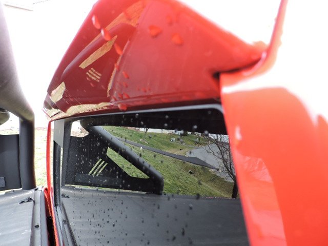

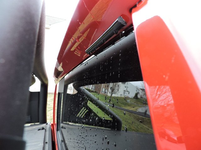

No leaker here so can't do a 100% verification, but the problem seems to be with the spoiler design, regardless of weather the sealer leaks or not, and any cracks in the trim make it worse.
Retirement leaves me plenty of time to have fun - so why not play with the rear window.pour some water not on the roof, but on top of the spoiler and watch the action.....water curls underneath the bottom edge of the spoiler and curls under onto the top of the plastic frame holding the window.....heavy enough flow with a crack in the frame or even a minuscule leak in the seal (or along sides of the window which is not included in the GM seal fix) will go over the top of the seal and into the headliner and drip down the window.
Previous poster and my previous post had the idea of a placing a drip rail on the underside of the spoiler. Today I tried it without as described above and then with a drip rail of 1/4" side molding tapes at the bottom of the "drip rail".  It was too cold to properly place across the whole length but a shorter piece proved the drips now came off the bottom of the molding onto the back of the window instead of curling back under the spoiler and onto the top of the frame.
If you have a leaker you should get a bottle of water pour it just on top of the spoiler and see for yourself.....what have you got to lose?..........if you have a leaker and want to try a molding across the bottom of the spoiler, it can always be easily removed with no damage. Might even be more effective with the molding placed across the seam of the spoiler and resting on the window surface.
See photos (video won't load) Take it for what it is worth.....shows water curling under the bottom lip of the spoiler on top of the window frame and drips coming off the molding instead of curling under the spoiler.
DSCN0868.JPG.0f48a7580aa9ccf85c3ff1ce474738db.JPGDSCN0873.JPG.d0c846b2cda3dab79cdb78989e894465.JPGDSCN0875.JPG.3e30c8f56499bfa457a65658f757be11.JPGDSCN0877.JPG.b06efbc219aa48d6c83058a15dc4d7ab.JPGDSCN0878.JPG.743c7648f386251571ea39adebdfbdbf.JPG
We need some guys with leakers do this and see, I will be doing it as soon as I get off this remote location and get time.
I went and tested my leaker and what is stated above is correct however water can enter the top of the window frame from the front of the spoiler as well. I poured water in the small void/indention on the top of the cab edge and it simply ran under the spoiler edge onto the top of the window frame and into the cab. Therefore any water on the roof while driving will channel to this void along the edge of cab down the weatherstripping on the roofs edge and under the spoiler. I am going to try to find a way to prevent this along with doing weatherstripping on the lower rear edge of the spoiler at some point. This is such BS as I am not willing to take mine to the dealer yet for them to tear up...
