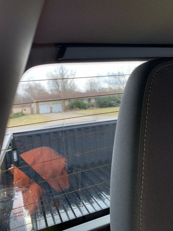

Add me to the freaking list. October 2019 built with sliding rear window. First time seeing this on my truck, probably has been happening. Thought my glass was cracked at first but nope, water running straight down the glass inside.
