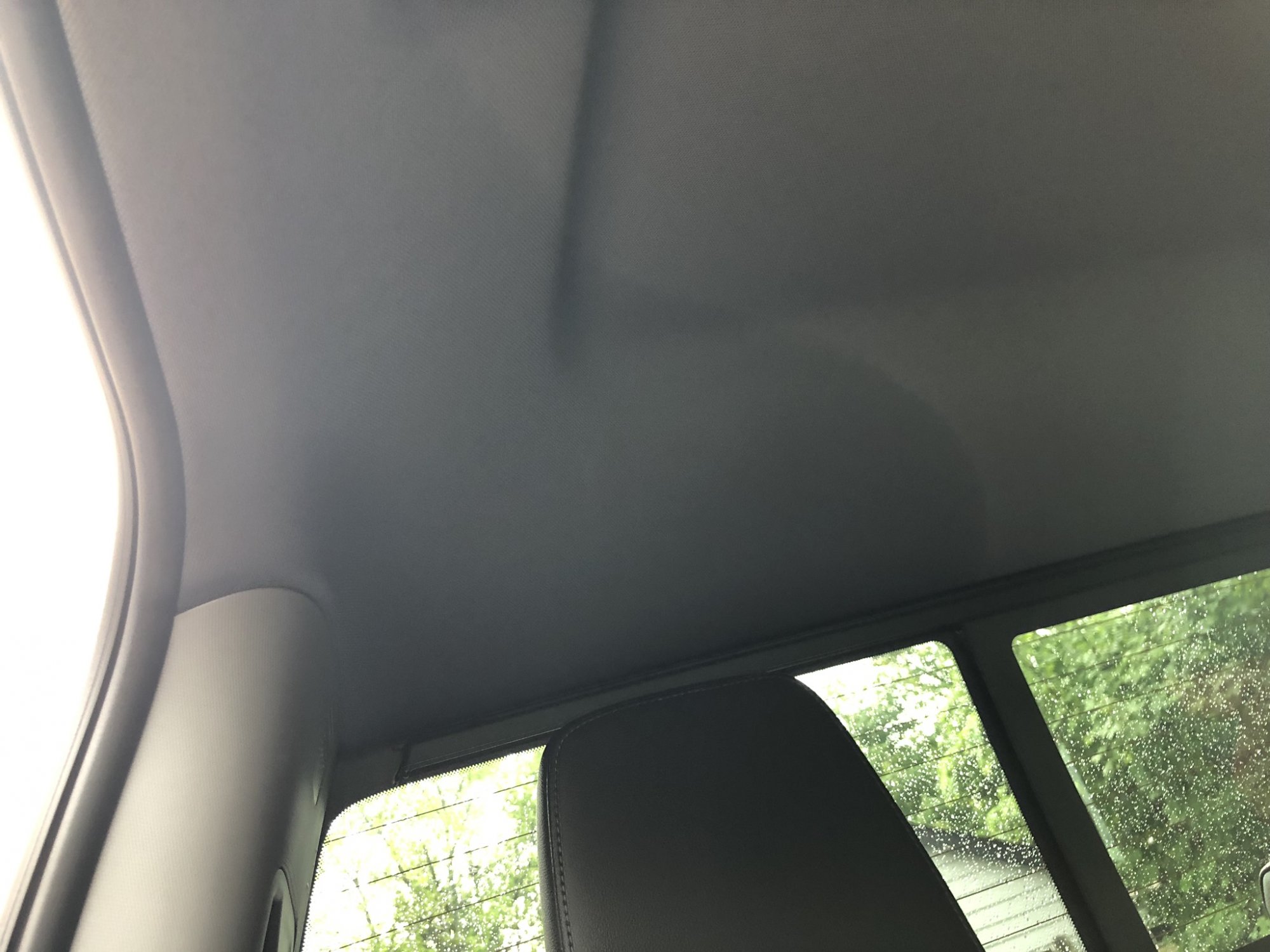

Mine got replaced. I wasn't aware of the leak issue and noticed some lines in the headliner so I got it all cleaned, only for a week straight of rain to have me find this forum. The picture was the day before I brought it in for repair.0f20b2936c106bb8c6aa09d435bd45ba.jpg

15 hours ago, Chet said:
Mine is getting worse too.  Doesn't even take much moisture anymore.... just a light rain and the interior is wet.
They discovered a foot of sealant was not applied?  Is that new info?  Source?
The service writer told me a foot of sealant was not applied to my window from the factory.
That leak is definitely spoiler related.
Yeah, mine was def the spoiler according to the tech who repaired it. On the opposite side not pictured, the headliner wasn't really wet but water was pouring down inside of the back glass. They went through it pretty thoroughly, and so far so good. Hoping it remains that way.
