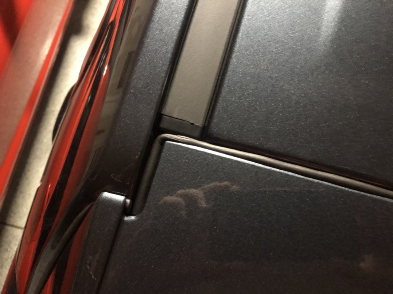

Update on the Trim Lok. Had a few days of rain here and no sign of leakage. I highly suggest you give it a shot. $15 and about 15 mins worth of time.
Trim-Lok Cord Stock Rubber Seal – EPDM Closed Cell Solid Foam Tubing –... https://www.amazon.com/dp/B00NL4D2T8/ref=cm_sw_r_sms_api_glt_fabc_HDPVNV15K4PR83SC6V7E
Do you have pics of where you installed yours? Which size did you use? I bought two different sizes and was planning on putting some at the top of the spoiler and at the top of the window frame, but thinking I'll skip the window frame.
I used the .25” and put it in the gap where the spoiler meets the roof.
Thanks! That’s exactly how I was thinking of putting what I bought.
