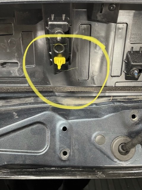

Have them check the clips for the spoiler. Here is a pic of before (on my truck) and the “new” style clips GM is sending out with a gasket. Hopefully it’s as simple as that and not the window...

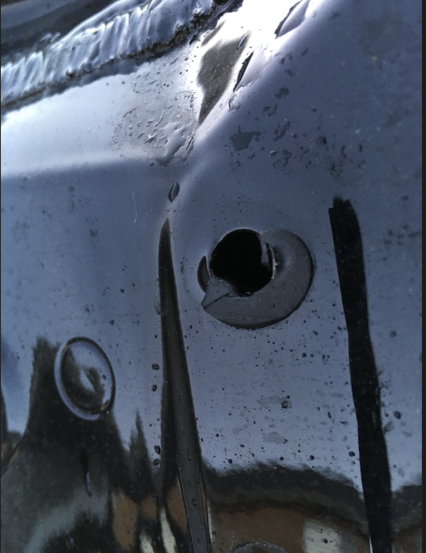

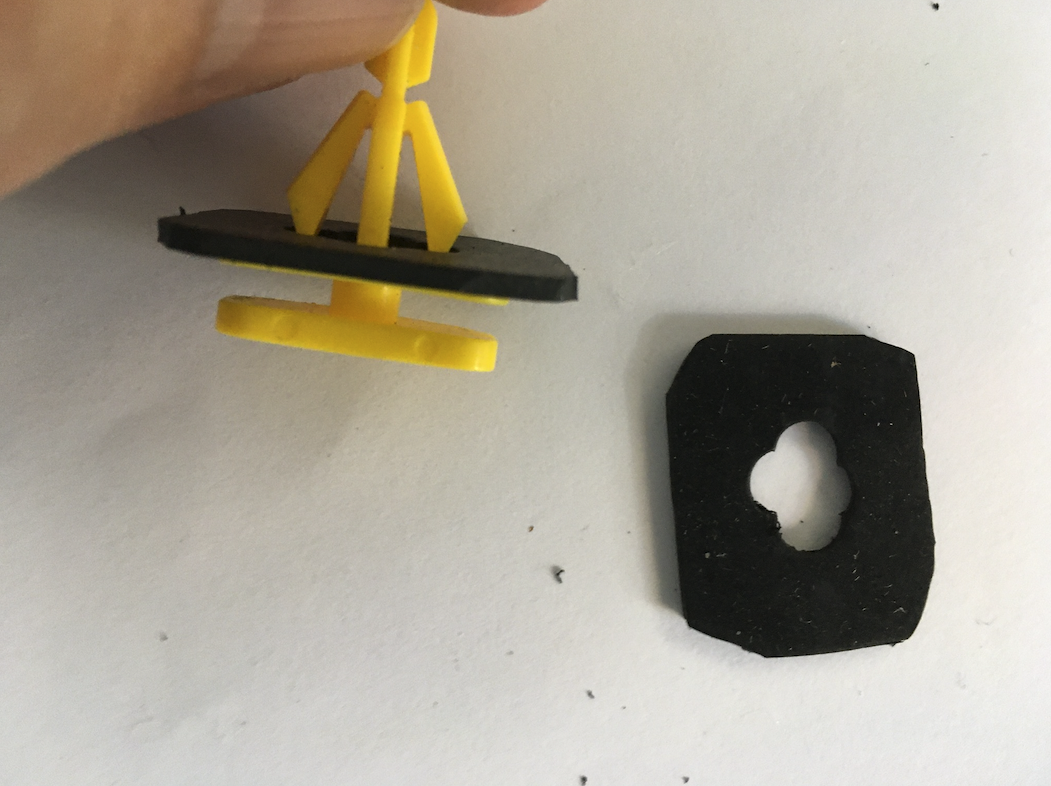

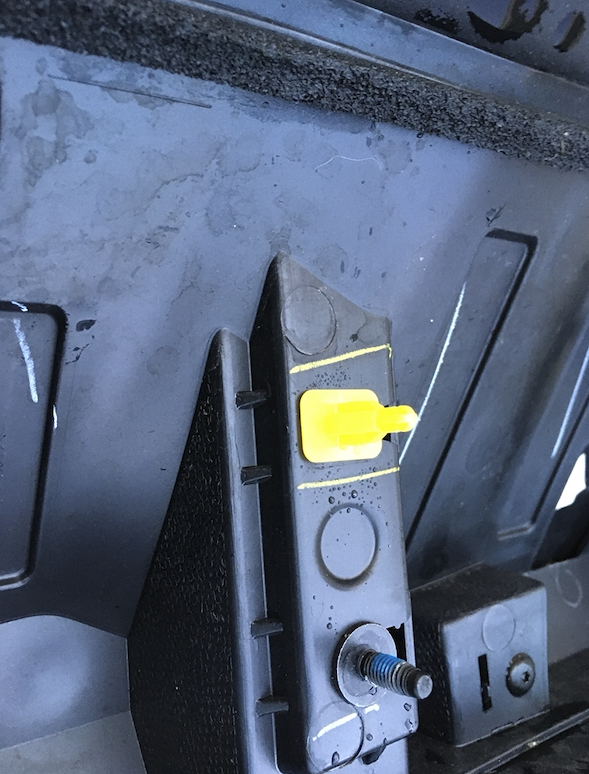

It's possible this leak is coming from the yellow retainer.  The area of the stain is exactly below where the retainer sits.  It has a very thin and flimsy/delicate gasket that can easily be damaged when you pull the spoiler.  I had the same leak the 2nd time around.  I had to make my own gasket because when I order the part GM didn't include the gasket.

Edited:  Yup, Dali555 beat me to the punch.  My gasket got stuck on the cab side where the retainer goes in.  I thought it was missing the first time I took off the spoiler, but it's there and mutilated.
