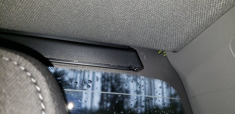

Can someone explain why it’s so common for the sealant fix to not work? You’re literally plugging everything with sealant, it makes no sense. I can see maybe after some time the sealant shrinks or cracks, but what about this example where they do it and it fails the test right after?
I agree if sealant is of sufficient quality and is applied evenly and properly across the top of the frame there should be no way for the window to leak even with continued cracking of the frame.  My bet is sloppy work or the sealant not being evenly applied across the top of frame.  I also I just went out and checked my window to not jinx myself.  3 months after the repair date my window is still good, no leaks.  It has also been raining at least 2-3 times a week and the truck has been through almost daily freeze thaw cycles.  I guess I was lucky that the dealer did a good job so far.  From this thread I tried to explain to the service manager most likely the leaks were from small cracks in the frame and to try to apply the sealant evenly across the top of the entire frame and on the frame itself as people were getting continued problems after initial repairs were done.
Once the spoiler is put back on it is almost impossible to tell how good of a job the tech did.  I could see through the gap though it appeared they applied the sealant over the top of the entire frame.
I really love my truck and aside from this problem I feel like the purchase was a good one.  Baring any further problems I'm hoping to keep the truck for awhile.

Sorry to say, I get to join the club. 2020, RST/Z71, 5.3, build date 8/1/2020. I guess I'll be dropping by the dealership next week to schedule a fix.
One car wash and 2 days of being in the rain, all good. Hopefully that’s the last time I think about it
Going in for a third time this Tuesday, this time to a different dealer. Bringing it to the dealer I actually bought the truck from. GM also contacted the dealer on my behalf. Gotta say, they've actually been on top of the dealers to get this resolved. We shall see....

Picked up my 2020 SLT after dropping off for second round. They replaced the whole frame and glass. Work was done by 3rd party glass company. Now I just need it to rain or sit out there with a water hose.

Rained all day here yesterday. Still no leaks. I keep expecting to see one. I drove the old truck today. 17 years old and still no leaks.

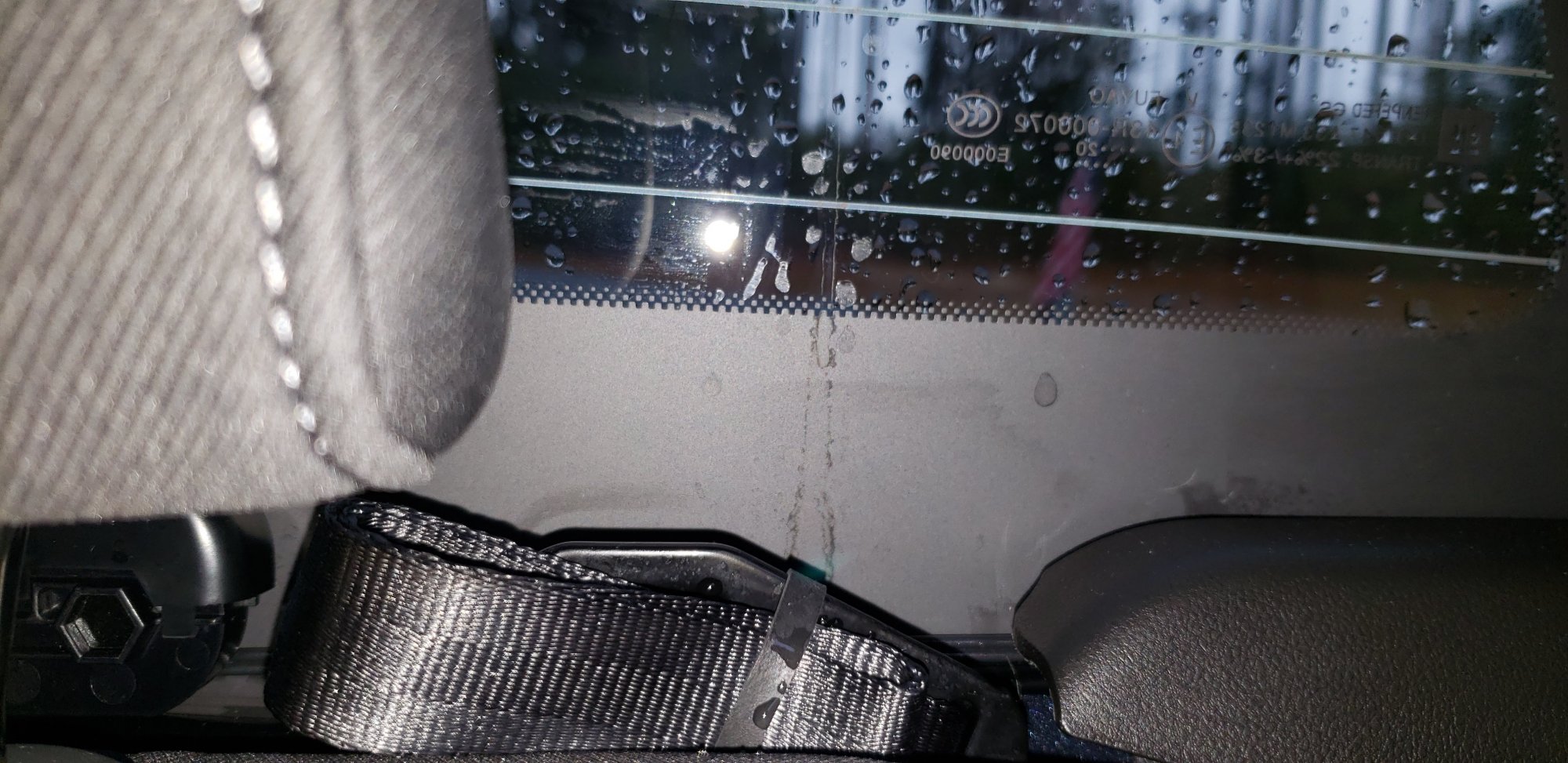

IMHO.  If there’s any takeaway from this thread; it is that even if they replace your rear window, you should have the dealer apply the sealant from the get-go.   Because eventually that new rear window slider will leak.
100% correct. My third leak was due to them not doing that ^.
So yeah, the replacement window cracked and they had to apply the sealant six months later.
